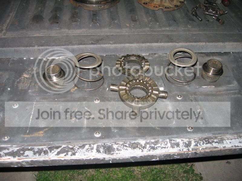

Make sure to get a pic first just to make sure the guy knows what he is selling you. Could very easily be a gov-lock and he doesn't know any better or he does and is going to rip you off.
yeah i requested a pic for sure. im pretty sure i can spot one with the four rod things. ill post it up here though, maybe yall can spot something i couldnt.
This is what it looks like. The ad said "This is just the locker".

now his is all apart without that bolt holding it together...
i wouldnt doubt it that he knows members here or even is a member here as well. if you are thanks for the pics!!
That is definatly a 14 bolt detroit. i would buy it as soon as you can. like wrench said they are either new or blown up and obviosly its not blown up lol
Well, the teeth can (rarely) be rounded off on Detroits. Broken shafts and/or errant metal can hurt the locker. Otherwise, they pretty much last forever.
A closeup picture of the teeth on each side gear will tell you what you need to know, but its probably fine.
