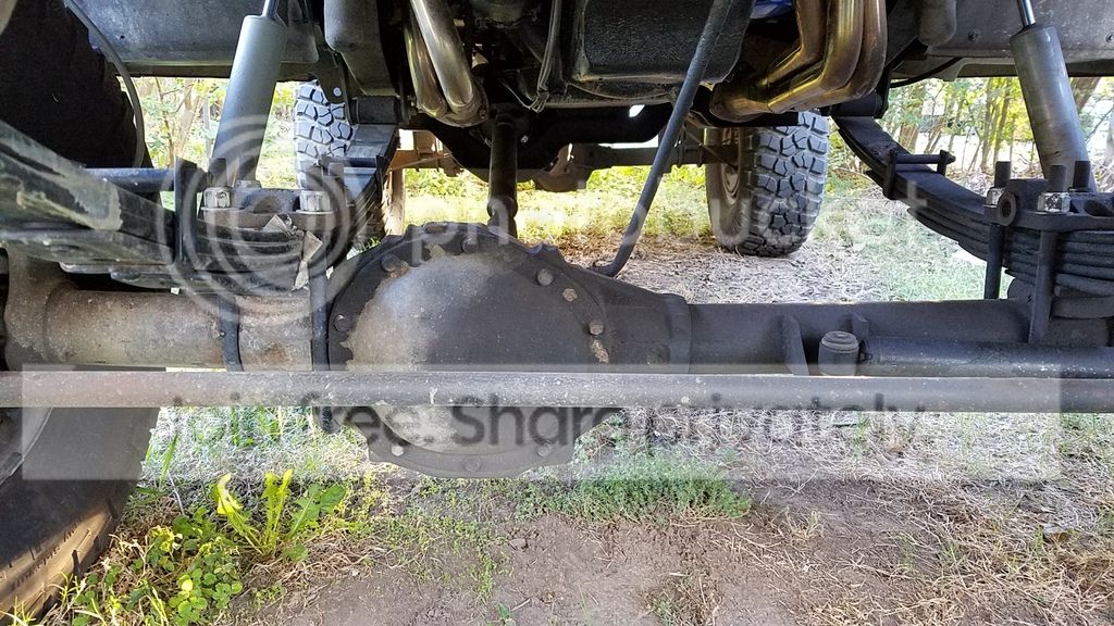

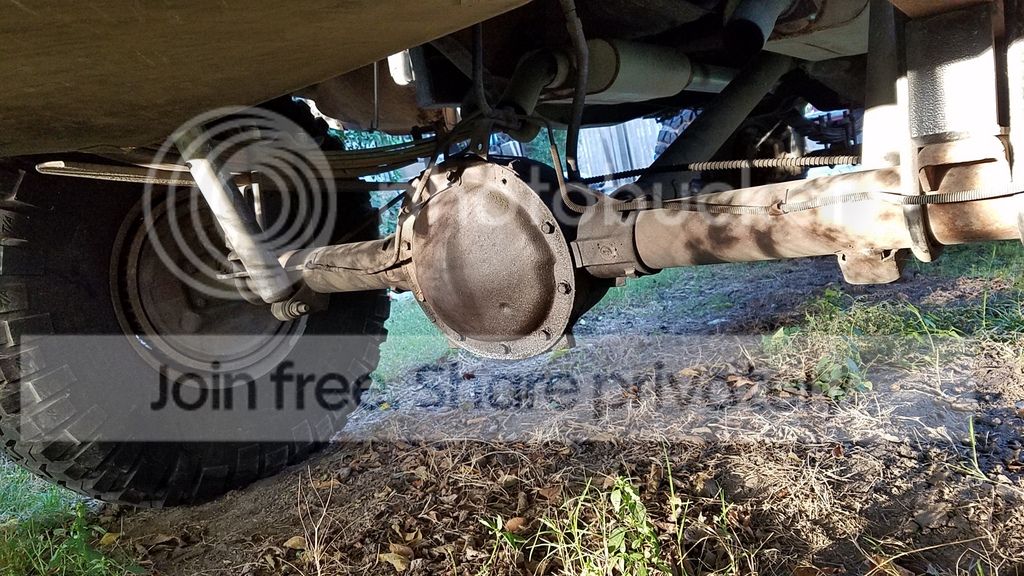

At this point, I've been thinking about how to do an axle swap, and I've come to the realization I do not have the support available for lifting/supporting a lifted vehicle. So I've decided I'm just going to save and buy 4.56s and put them in.
Just as verification, the are both 10bolts with the 8.*" carriers correct?
Yes, both are 10-bolts with 8.5" carriers. Why bother redoing both of them? Are you wanting 4.56 gears anyways?
The original plan was the roll the 3.42s til i could afford 4.56s as according to my math, 4.11s with 35s, buts me back at 'stock ratio'. and 4.56s puts me a little over, so I may cruise at a higher RPM, but it may give the trans a bit of relief.

There are a number of such drop-in "lunch-box style" lockers, but I'm not sure what such options exist for the 8.5" axle. You can replace your spider gears with a solid bar which will be locked all the time (mini-spool), but I'm not sure what other lunchbox options are available for this axle. It's not hard to break 10-bolt axle shafts with low gears, lockers, and large tires. Consider that before dumping hundreds of dollars into gearing, lockers, and tires.
Pushing front wheels around is also more difficult if the front axle is locked, so a lot of guys wind up reinforcing and upgrading the steering system significantly after a few trips with a locked front that doesn't want to steer anymore. You have been warned. ;)
Also, check both axles axle before buying any parts. If you have the G80 "Gov-Lock" option the carrier is different and lunchbox lockers won't work anyway. It's also worth noting that 8.5" G80 carriers have a fairly high failure rate, even without any offroading abuse.
Of this I am aware lol. I know they are called gov-bombs for a reason. It would surprise me if it was a G80 still.
