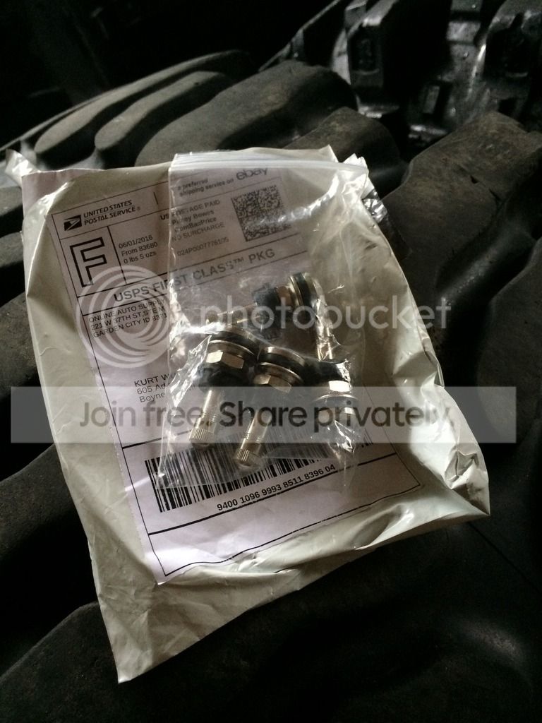

Ive had it happen many times.. I use the High pressure stems when the tire shops dont have the metal ones.

and walked outside. my truck had front drivers and rear passenger flat, dead on the ground. took the tires off and off to a shop. I was trying to figure out who would of snipped my stems. When i told the guy he looked at a good tire.. reached over.. bent stem and it shot off.. he said... Yup dry rot.
he said valve stems are only good for 6-7 years. Typically tires get replaced every few years so they say. he put 1986 corvette stems on. All metal and was like.. there your problem is solved.
