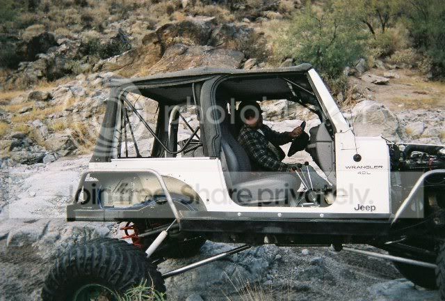

I just installed a STak in my brother's TJ. (Can see shift levers :D)
He had a similar request because he said that his old low range (2.72 in a NP231) was too low for sand dunes yet too high for rocks. So we went w/ the optional gear ranges of 2.4 and 4.3.
I don't think you can get the 2.4 w/ the 5.4....
Oh... and the STaK is more $$.... We paid $3100 for this one. It's a fine piece tho... and so far delivers all we wanted! :waytogo:
If you're not "weight" concious, I'd say go w/ the 203/LoMax205. If you are on a diet, looks like Atlas is king.
