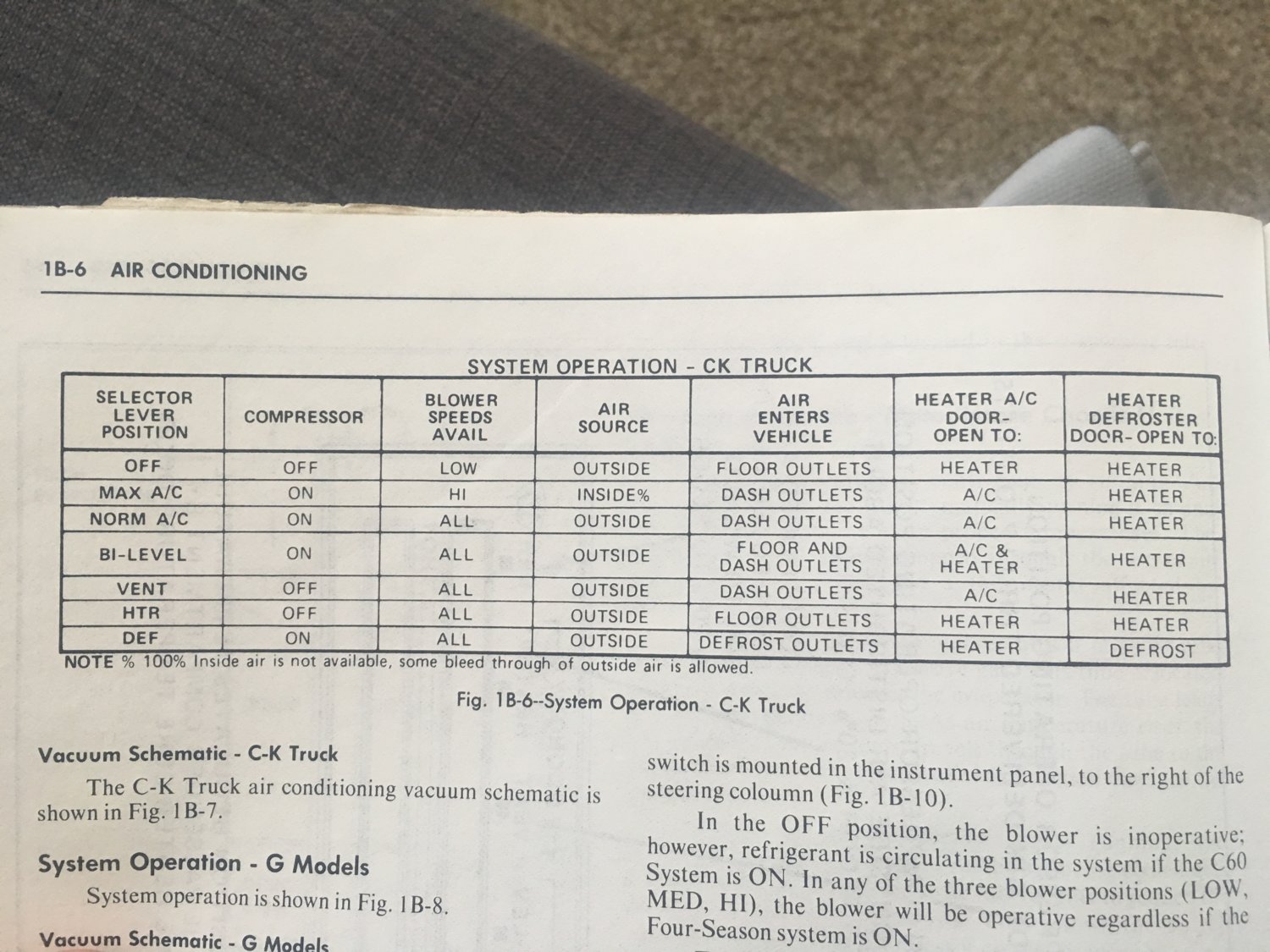

Hey everyone. I’ve searched until I’m blue in the face and can’t find help on this topic. My ‘82 Jimmy is equipped with A/C (although it’s not working currently). One major issue: my fan is always running. The switch is in the “off” position and the fan still runs. I also don’t think that switching it between floor/vent/etc is working but I’ve read that is probably the blend door. I have the dash apart so I can clean all of the ducting and re-fit vent gaskets. I see the linkage for the hot/cold is a physical linkage and looks to work just fine. The vent mode selector goes into a wired harness and maybe that’s where my problem is? Would buying a new A/C control fix this? Ideas? I figured I need to get this sorted before worrying about the A/C.
I believe that is normal on non A/C equipped square bodies--GM introduced a "flo thru ventilation" feature sometime in the 70's on square bodies ,that consisted of the blower running at low speed (even in the "off' position),and the louvers made into the door bottoms and the part of the door facing the jamb area..
I hated the blower constantly running in my pickup,as it would emit a horrifying screech once in a while on frosty mornings ,so found which wire on the plug that goes on the resistor (under the hood at the blower motor) that powered the low speed setting and removed it from the plug..taped it to the other wires..
On an A/C equipped truck I believe the fan switch only has "low-medium-high" settings--to kill the power to the fan completely you have to move the upper slider lever to the "off" position..then it should stop running ..

Update: upon further inspection, the metal arm that goes into the vacuum selector module was bent, not allowing the module to click into the off position while the switch was in the off position. It also was preventing the switch from going into defrost mode. I bent it back up but will likely buy a new switch mechanism as the face of mine is pretty beat up. By manually clicking the vacuum selector into the OFF position, the fan does not run at all, which is what I was hoping for :)
