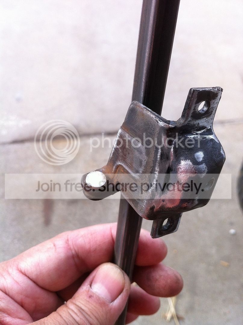

From what I have rear you have to use what they call a crush rivet not the normal pop rivet I am use to using is this true?
Can any one school me in installing crush rivets correctly?
1Atony weather strip kit comes with 1 piece vent window seals, mine has 2 piece design so be sure you know which one you have first. Requires you taking it apart. Sent him a pm see if I can swap them out or what not.
Plan on blasting frame monday and painting it satin black. Figure if this far in Do it correctly 110% so everything is being replaced or refurbished.
Tips and tricks welcomed. So far it is not that bad just wish I had all my parts on but waiting now.

When I did mine on the '86 a few years back I did the driver's side by removing the crush rivet/pivot pin and it was a pain getting it to crush right. Never came out the way I wanted so for the passenger side I drilled out the pop rivets instead and kept the "hinge" intact. I was still able to slip the new seal over the assembly and came out much better. (before painting)
Found LMC makes a vent window repair kit comes with screws,rivets and tool to smash rivet correctly for $11.00. Want to call and see if it comes with rivet in your pic that window pivots on on the kit.

There semi finished to hard to close. The guy's at precision seals and there trying to help me out through pics i am sending. There a pain in the butt. I have the 2 piece and getting the new reviets to crush right is fun. I ordered a tool that is made by kentmore cause I like tools!
