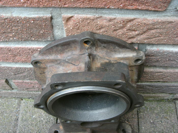

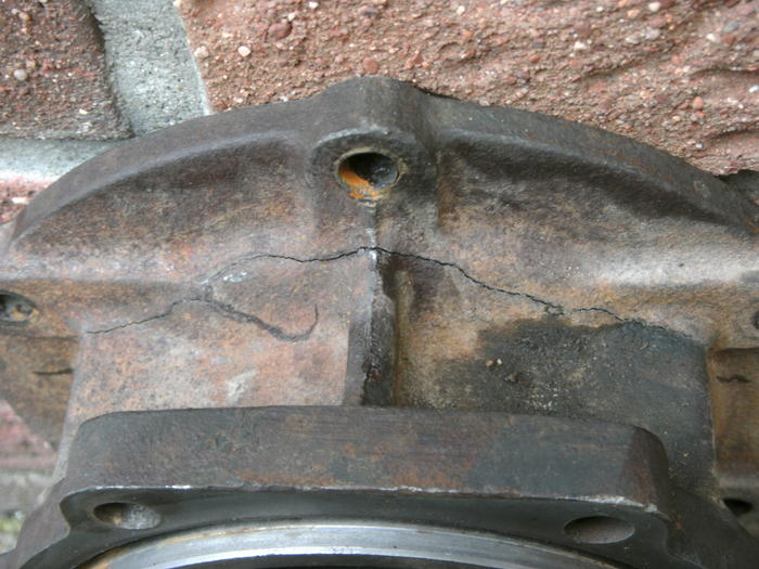

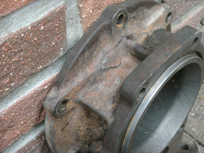

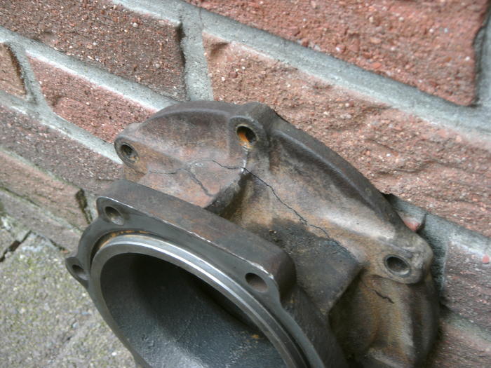

After removing and cleaning the adapter I discovered the cracks on it (no wonder dexron poured on my driveway).
Wondered what caused this to happen? Is it the result of the vibration or the cause? My tcase rubber mounts are bad, but not that bad i think. Just 25 years old and oil soaked . . .
