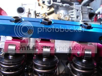

so i have been offline for awhile. this 58 has kept me super busy. finally got the 406 dialed in. dyno says 450 hp 525 lbft torque. put in a built manual/ auto th350, 3000 stal conv. new np 208. scored a 14bff and 37 mt baja claws. gettin 6" lift parts list together now. lookin for a 8 lug front axle now. enjoy the video. ill have one of her on the road rollin soon.

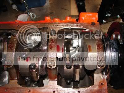

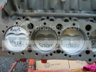

Sweet. What are the specs on your 406? I'm planning on building one for my '80. I'd like to go around 9.5:1 with aluminum heads and a solid cam, possibly a roller.
a 400 that has been completely rebuilt with 450 hp /
525 ft. lbs. torque. @5000 Block has been bored and honed with torque
plates. Decks have been squared. New cam bearings and freeze
plugs.
New scat forged crankshaft that has been balanced. GM PM rods
resized
w. ARP bolts and balanced. Speed pro. Light weight LW2606F coated
dished pistons balanced. 9.78:1 compression Crane hydraulic cam .516
525 lift 244 252 dur at .050. 110 lobe sep. pro comp
aluminum
heads. 64 cc chambers 195cc runners 2.02 1.60 valves ported and polished. cnc bowl blended Springs to match the cam. five angle
valve
job. Decks have been surfaced. Set of 7/16 shaft mounts. Full 1.6:1 roller
rocker . Comp moly pushrods. Speed pro moly rings. True roller
timing chain. Felpro gaskets. ARP headbolts.melling oil system 7 qt pan with dual gates holly street dominator
intake and a edelbrock performer 750cfm recalibrated msd pro billit hei dizzy
Vintage tin

to 87"k5boggin. the 2 bolt mian block is a better choice in the 400. if i was gonna turn it up more than 6000 you can splay the caps and make it way stronger than a 4 bolt. with this application i built it for low end torque max of 525 is at 5000. didnt see the need for splaying. i have turned up to 6500 a few times when i first built her doin burnouts and just testin the waters.400's being notoriously famous for not liking above 6000. also unmolested 400 blocks are hard to find. most are already .030 over or cracked.400 blocks prone to cracking. they made a high nickle content block if u can find one.if you find a block that isnt cracked chances are it wont crack. i personally wouldnt go more than .030 over on a 400 although people do. with a 406 being a sought after engine in racing stock blocks are getting scooped up by them. thanks for the killer feedback makes a guy feel good..... oh and it is all on a k5 frame
