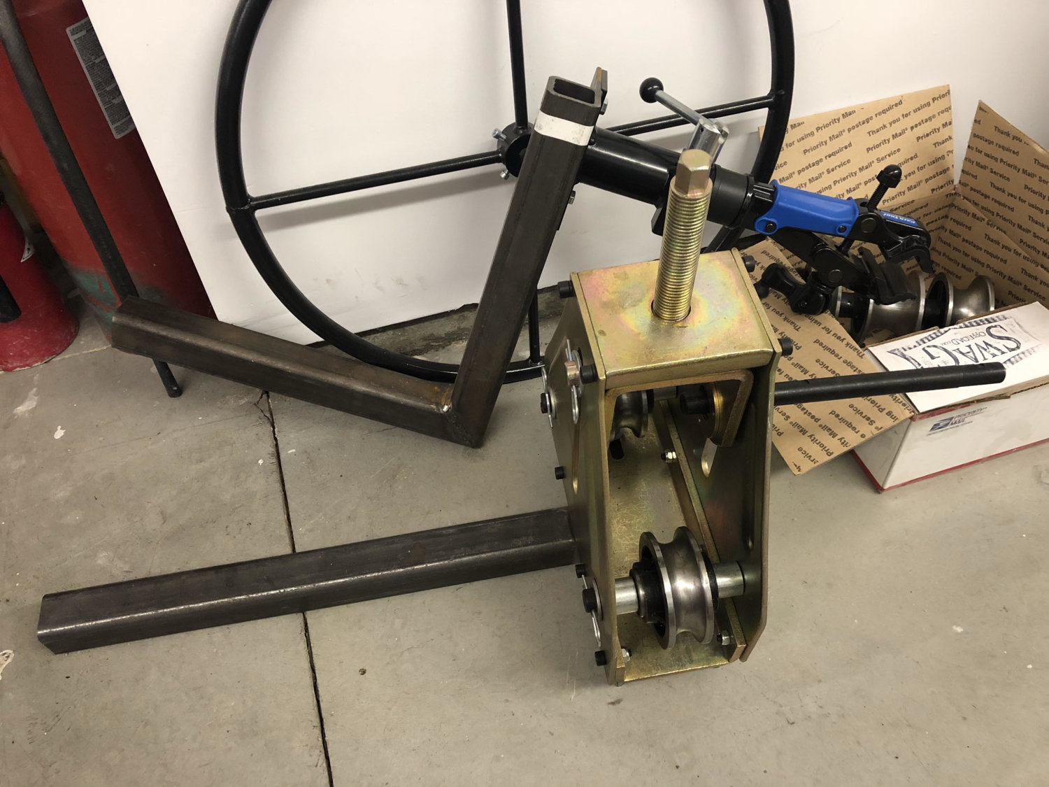

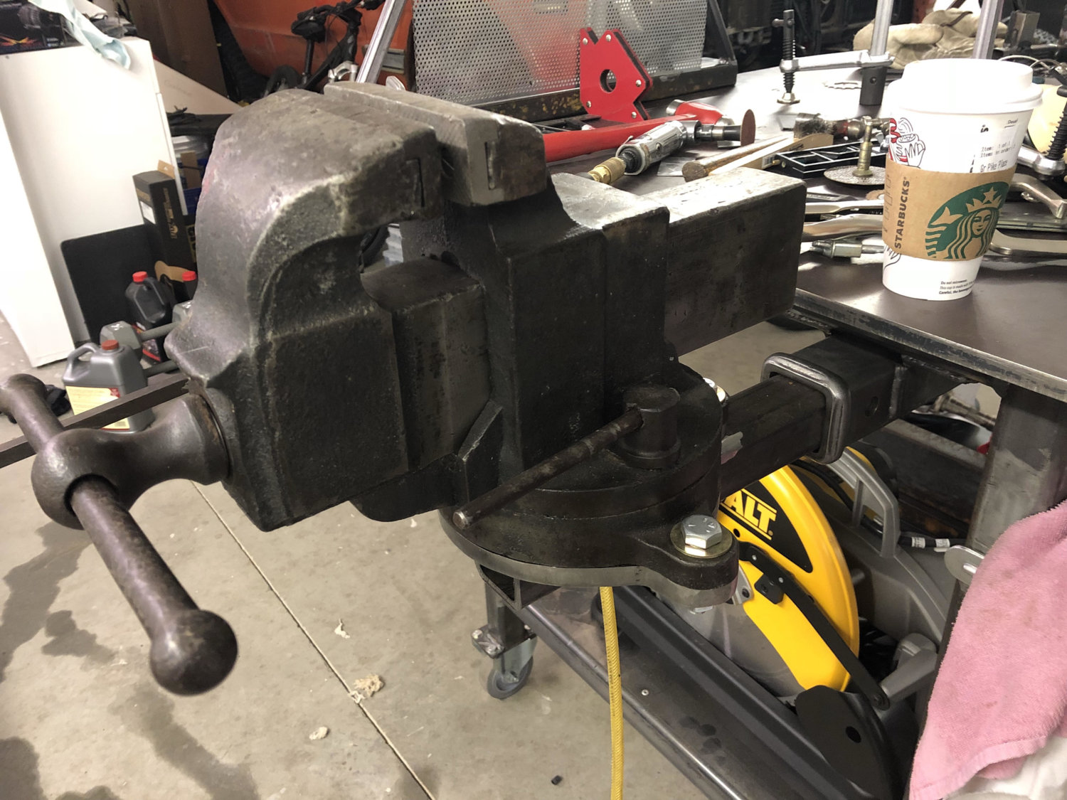

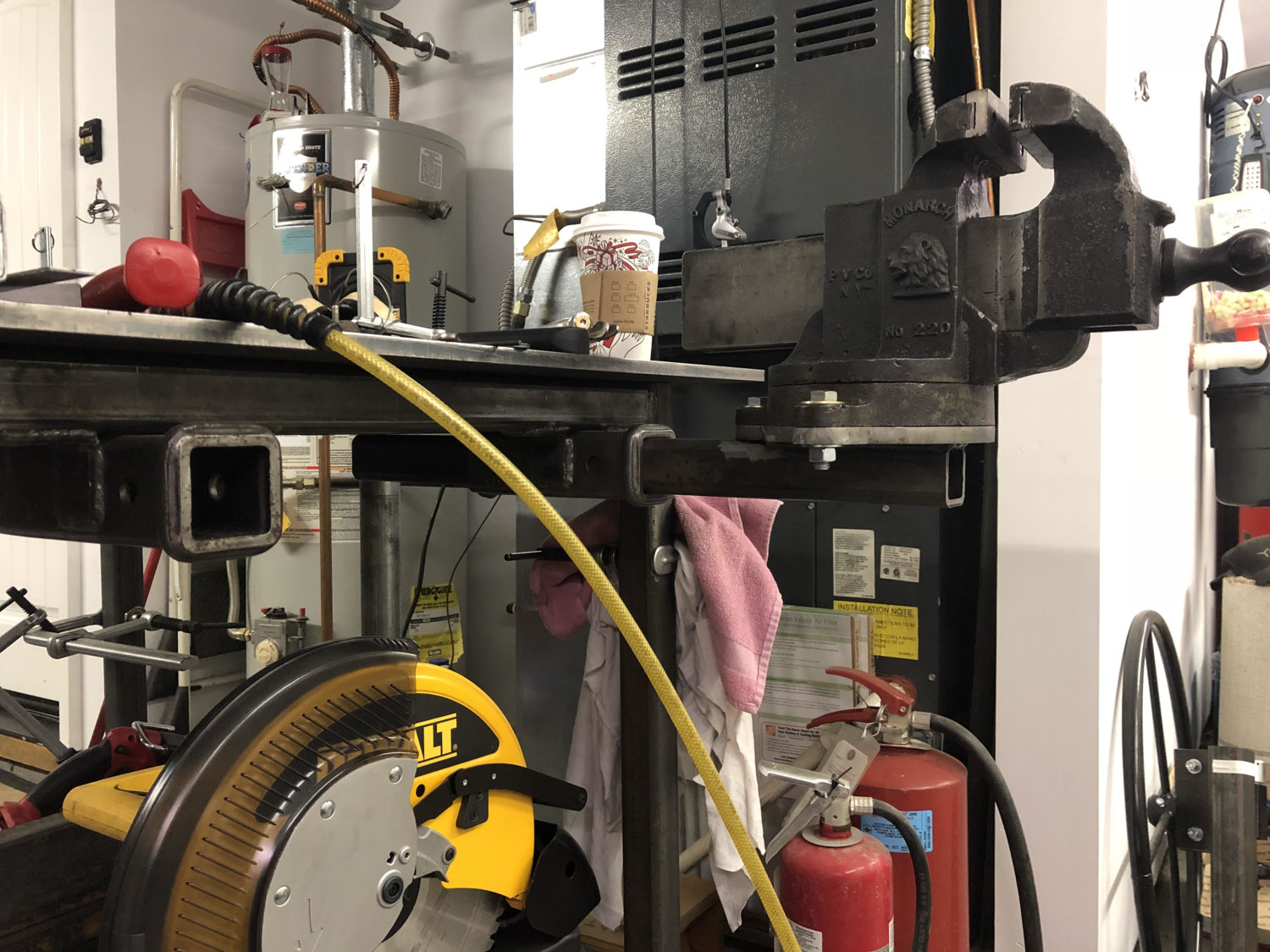

Here's a couple of how mine looks. By no means do I take credit for coming up with this, as its a pretty common method for mounting tools. Similar to Diesel4me's explanation from a few posts up.
Never mind the surrounding mess.
Maybe a permanently mounted receiver set-up, that way other tools can be mounted as need, then stored out of the way when not needed/in use.
Is that the swag tube roller?
