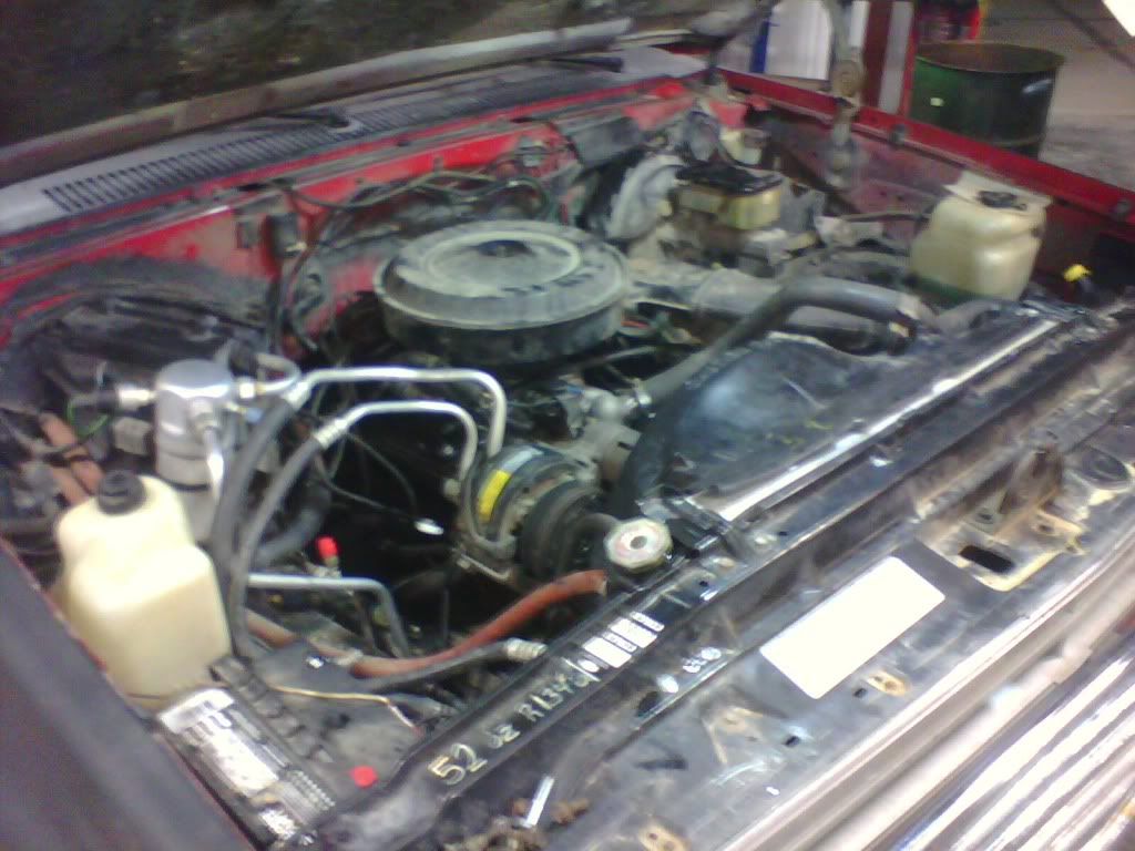

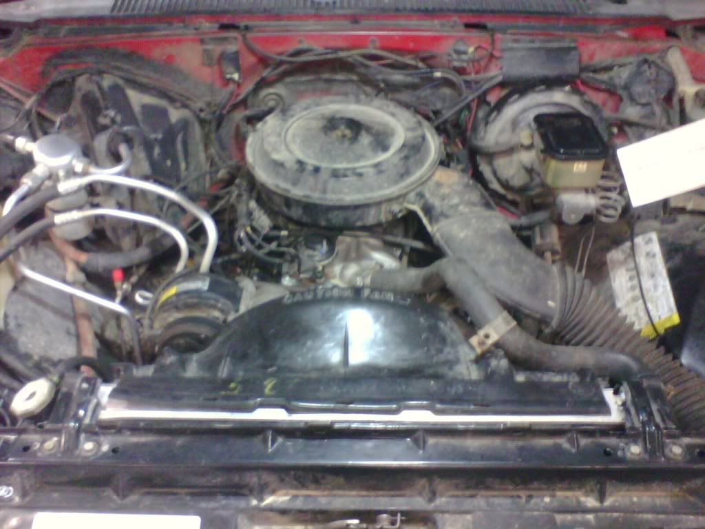

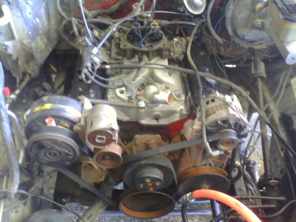

I swapped a serpentine setup from a 1992 Camaro onto my 1988 V10 Suburban.
Here it is pictured with the AC compressor from the Camaro.
That compressor was no good. It had been open for several years. The clutch was fine though. So I swapped that clutch onto my factory AC compressor. That gave me a serpentine pulley instead of a v-belt pulley. I then gently bent the hard AC lines by hand, and made the AC compressor from the driver's side move over to the passenger's side.
Sorry about the quality of the pictures. I could take some newer ones if you want to see anything.
