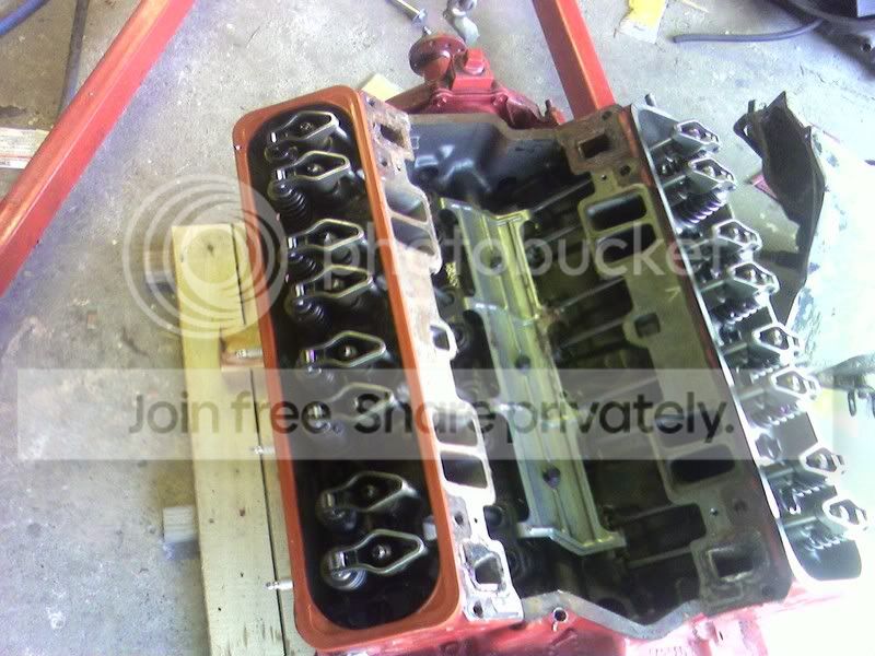

And just to be a pic here what its all goin in..

The votec motor with tbi will run good I did it in my 89 sub with no problems. With headers you will have to weld in an egr tube for the egr to work.
