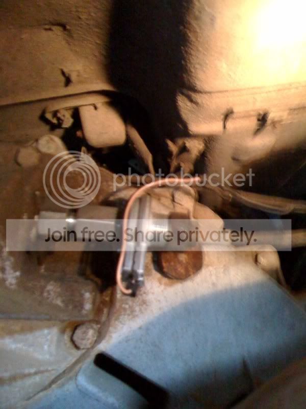

Part number SEN-01-4160 here it is on my NP208
