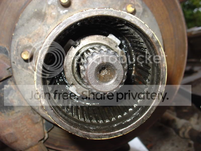

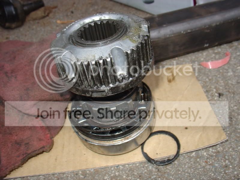

Ok so I almost done (ha yeah right :rolleyes:) with my x over and 52" swap but I cant get the knuckles off to put my flattop ones on. I've got the warn manual hubs mostly dissasembled but I cant figure out how to take the rest of them out. I assume I probably need a special tool to get this out?
What I've taken out so far:

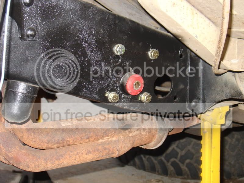

52" swap progress: I've got the front hangers bolted up too but my camera ran out of space :doah:
Thanks guys and sorry about the massive pics I couldnt figure out how to rezie them.

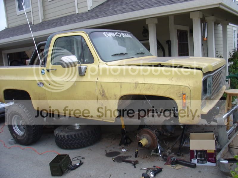

My truck as it sits now:
Someone left a note at my door saying that while the rest of the neighborhood is making their driveways nice I'm making mine look worse and its permenately damaged or somethihng :dunno: :haha:
yes, you need a spindle nut to take the spindle nuts off and the rest of the process will be self explanitory.

Ok sweet I figured. Easy enough to find (vatozone, etc)? And are they gm specific or universalish?
the 4 pronger which you need is the common 1/2 ton socket...it's like 9bucks or so and VERY COMMON> you'll take that nut off, then a washer, then another nut just like it....then your bearing will fall out when you remove the hub assy. so be careful not to drop it.

Assembly is not quite as simple. The innermost nut has a prong that sticks out. The washer between the two nuts has holes in it. Make sure you engage that prong with one of the holes in the washer. It keeps the inner nut from backing off. Once you get it apart and clean, you will understand.
also, when your putting the middle(washer) on...if it doesn't line up just right then flip it 180degrees and try again. the holes aren't always exactly perfect on them and it will probably fit the other way. while your in there, i would replace bearings/races/seals too....cheap insurance. i bought both my sockets at advance auto parts for like 20bucks for both, the big six, and the little four. good luck man.
