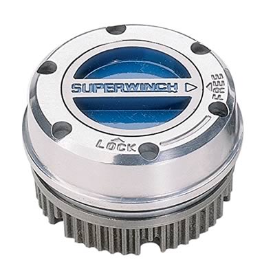

My answer to Warns are Superwinch hubs. They’re inexpensive and only a ¼ turn and I’ve never once had to reach under the truck to spin the axle shaft to get them to lock or unlock. I’ve never broke one yet either. Part number 400518

I've had buddies with the superwinch hubs as well and heard good things.

I've broken a Superwinch Lockout, but it was because I exploded the 30 spline outer in my Dana 60, and it was collateral damage. I have Yukon's now, and they are pretty tough.

I like the Warn standard. It has the same 1/4-turn engagement as the Superwinch, and the same internals as the Warn premium. The premium is harder to see which position it's in when it's dirty and has that silly gold color.
