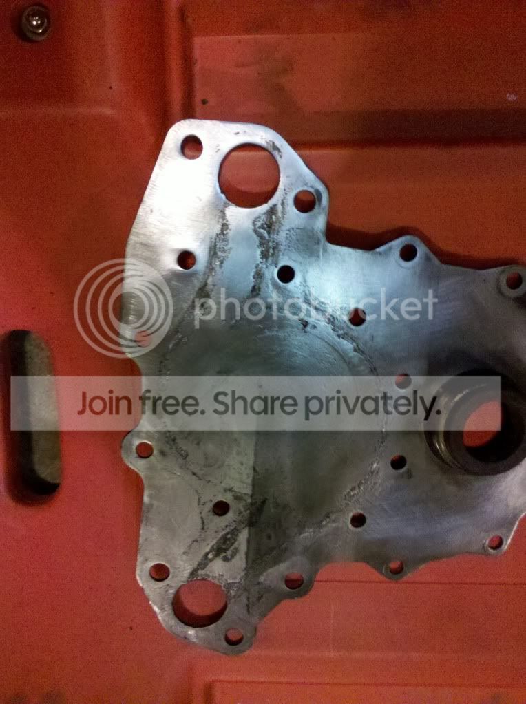

The backing plate the water pump bolts to has some serious pitting in it. Kristle is going to be induced on monday I need to figure this out.
My first thought was to fill the pits with jb weld or some similar material. I think it may be hard getting it leveled out enough to get the gasket to seal, second thought is too use the gasket and a small amount of rtv on the pitted surfaces. I know the real solution is to replace the backing plate,which I intend to do later but I would like to get this running before Monday
Pic
load it up with some ultra black and give it a shot...
That's a nasty one, but JB weld should fill the pits well enough.. If I had time I'd buy a new one... I just hate the thought that a little leak there causing a do-over....

OK.. the water pump backing plate saga continues. In the first picture in this thread it is clear that the water pump backing plate for a 6.2 liter diesel has thirteen holes where the backing plate bolts to the block and seven holes where bolts go in from the back and attach the pump. That's a total of 20 holes total. In the picture of the new backing plate I bought, there are only 19 holes. One of the holes for a bolt that attaches the pump to the plate is missing ! I had to finish this job before this weekend so I reused the old plate and just filled the corrosion pits with silicone gasket maker. No leaks so far..
