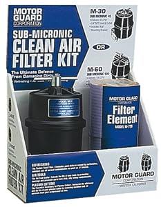

I ended up buying the Motor Guard M-100 with 1/2" in/out as the main the filter. These flow up to 100cfm at max 125psi.
Then I bought a pair of Motor Guard DD1008's to put inline right before the plasma & blast cabinet. These flow 20cfm at a max psi.
I'll report back after I receive the filters and get a chance to use them.

I have 25' of hose and then a 5 micron husky water separator and then a motor guard like above, then the lines T off to a couple spots in the garage. It seems to work well for the plasma cutter and blast cabinet. I just setup the same thing in one of the other garages for the CNC plasma table. The motor guard is rated to 0.01 microns IIRC.
