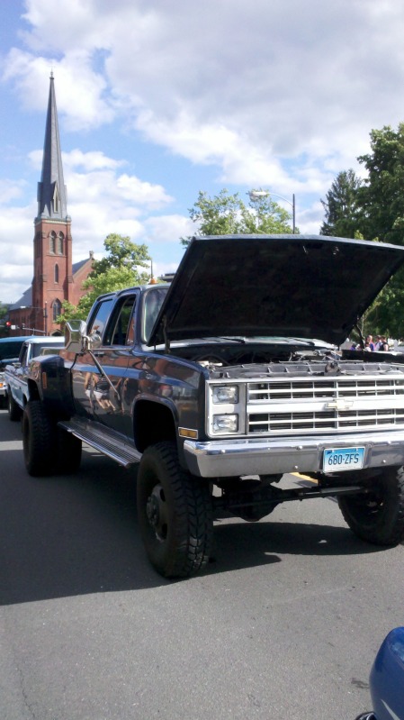

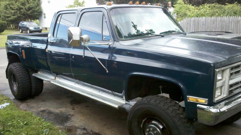

Just curious what is the best DIY wax to make these old trucks shine? I have been using a old tshirt/micro fiber cloth and some Meguiar wax and having halfway decent results. Every once in a while ill see some original paint that people shine up and it really impresses me but I do not know the best way to deal with this old 1 stage paint. I think my bed has been repainted at some point etc so looking to get it just a little better.
https://www.walmart.com/ip/Meguiar-...5035&wl11=local&wl12=871743&wl13=2144&veh=sem
I have used an old 6" orbital waxer with minimal results.
Doesnt look half bad when hand waxed.
Any tips for the land yacht?
