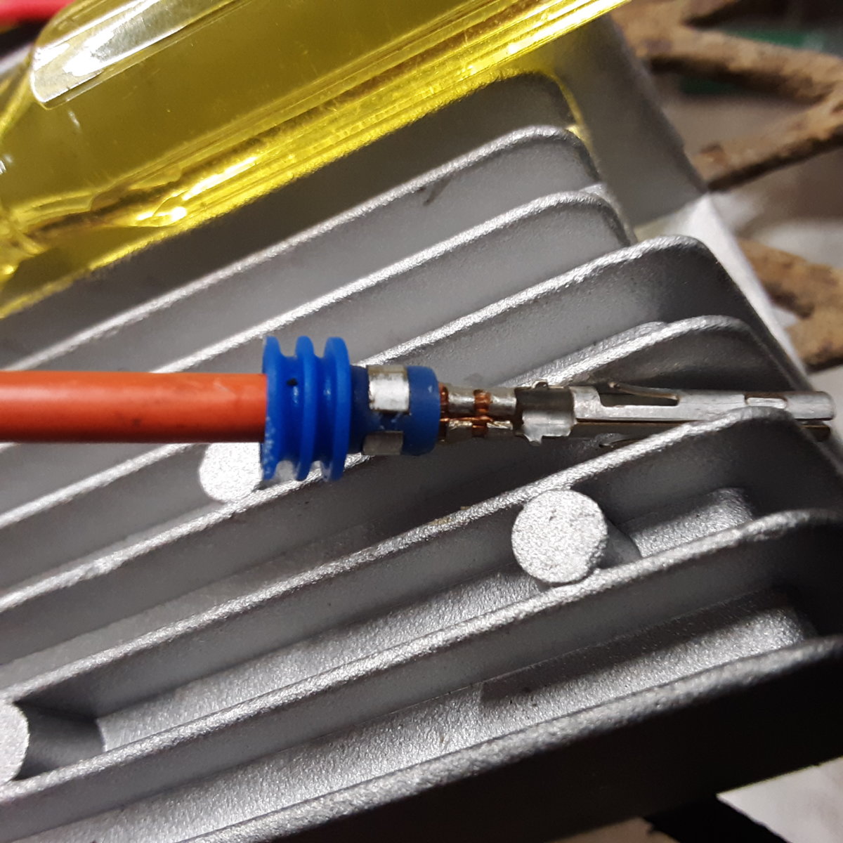

I drug my feet getting into weatherpack and now I wish I'd done it sooner. I use them a lot. I purchased a kit that included the crimper on ebay. Super easy to make them up.

I won't besmirch anyone for shelling out the money for good ratcheting crimpers, but I have been using this tool: https://www.amazon.com/GM-Delphi-We...coding=UTF8&psc=1&refRID=A5011FTZDQXCQEZJ8266 and if I do my part, the crimps are indistinguishable from factory. Note that you are limited by the connector/wire size on the crimp tools. You can make the smaller tools work on 10/12GA wiring, but it starts to look sloppy. But you also start running into the amp limits for the terminals as the tool gets too small.
