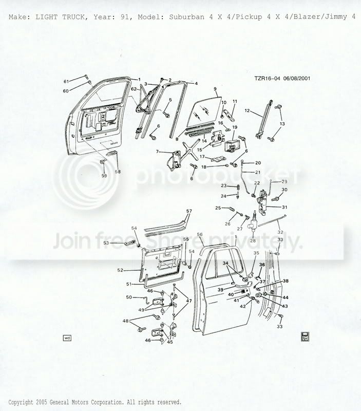

Friday took field trip to my local Chevy dealer! 07-14-2007, 08:35 PM
So Friday I decieded to take a little trip to my local Chevy dealer. I thought I would see what seals were still available for the cab and topper on my Blazer. Here is a report on my little field trip. The numbers and first price is OEM the last price is LMC Truck. I ordered mine and most will be here Monday the rest will be here Wednesday. Also got better pics of the tail gate and door parts.

SO YES GM STILL MAKES AND YOU CAN ORDER!
I decided to use GM because of these three things.
1. Fit
2. Fit
3. Fit
They may be more but they were made by its maker!
