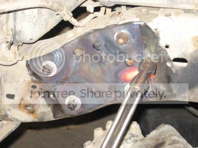

Bolt the patch panel on...heat and draw it together.
I'm not sure what Stephen would say about heating his panel..
It sure makes installing easier...the holes are flush without pounding the crap outta it.
