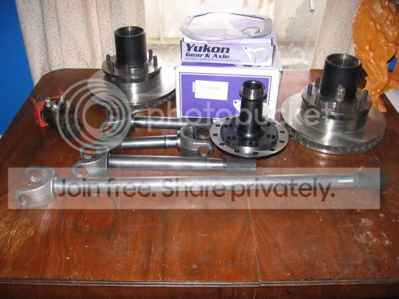

i'm not welded but this is what i put into my front 60:D
