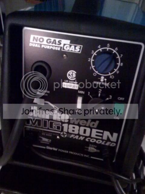

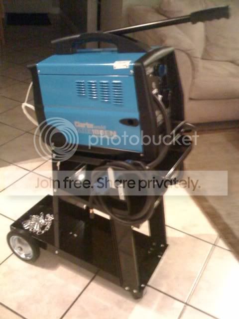

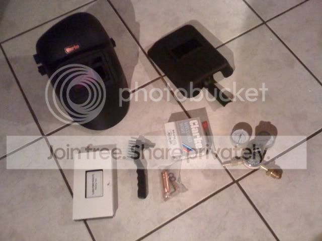

Finaly bought a Clarke welder but i decided to go with their 220v 180amp welder and i opted for the WE8000 kit which came with everything below. It all came out to $530 with FREE shipping.
Gas conversion kit, cart, Auto-Dark helmet and hand-held mask, replacement tips, wire brush and hammer, 2 spools of wire (.023 MIG WIRE / .035 FLUXCORE WIRE) and instructional video
