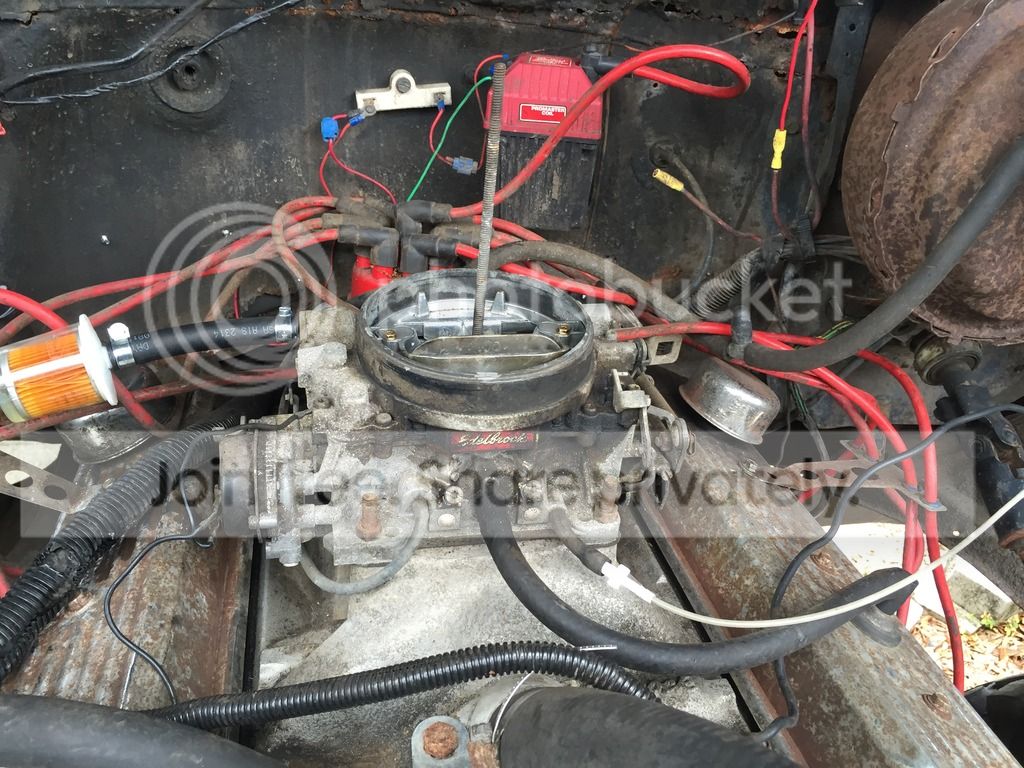

the ignition system is the original one that was on the truck when i bought it before i put the crate motor in. the distributor/coil im sure is probably tired/wore out, so im going there next. im going to get an HEI distributor, but im not sure that what i have now isn't one.
can anybody tell me what type of setup this is?
i literally pulled the distributor out, and dropped it in the new crate motor when i swapped it all those years ago.
i do not think it's an HEI setup b/c i had to crimp on the points style connections on my accell plug wires when i put the new headers on.
also, shouldn't my 83 have come from the factory with an HEI setup?
thanks so much
An 83 would have come with an HEI setup from the factory. That isn't an HEI system, and probably worth changing because of age. Do yourself a favor while you're in there, and clean up those vacuum lines and butt connectors/quick connectors on the wiring, those will just be headaches down the road.
