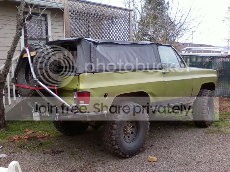

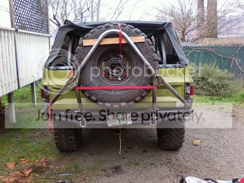

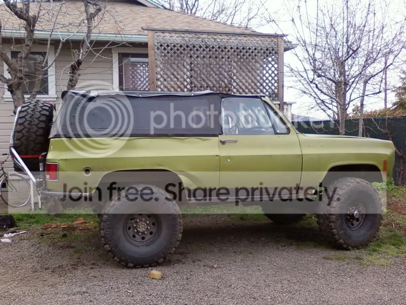

I think it will get the job done. Still have a few more things to add to it, finish welding, etc.
Still need to:
  1. install tire carrier plate
  2. receiver tube
  3. run a tube through some bolt-on flanges to the cage-to-frame mounts
  4. rear-quarter armor/carrier mount stabilizer bar.
  5. weld some some of those sick looking web gussets. :)
  6. cut off the excess that's next to the tail lights.
I think it looks mighty fine, for a fabrication newbie. :) The picture straight on from the back looks awkward due to the camera angle, so the profile pics are included to show that it is proportional to the rest of the truck. :)
