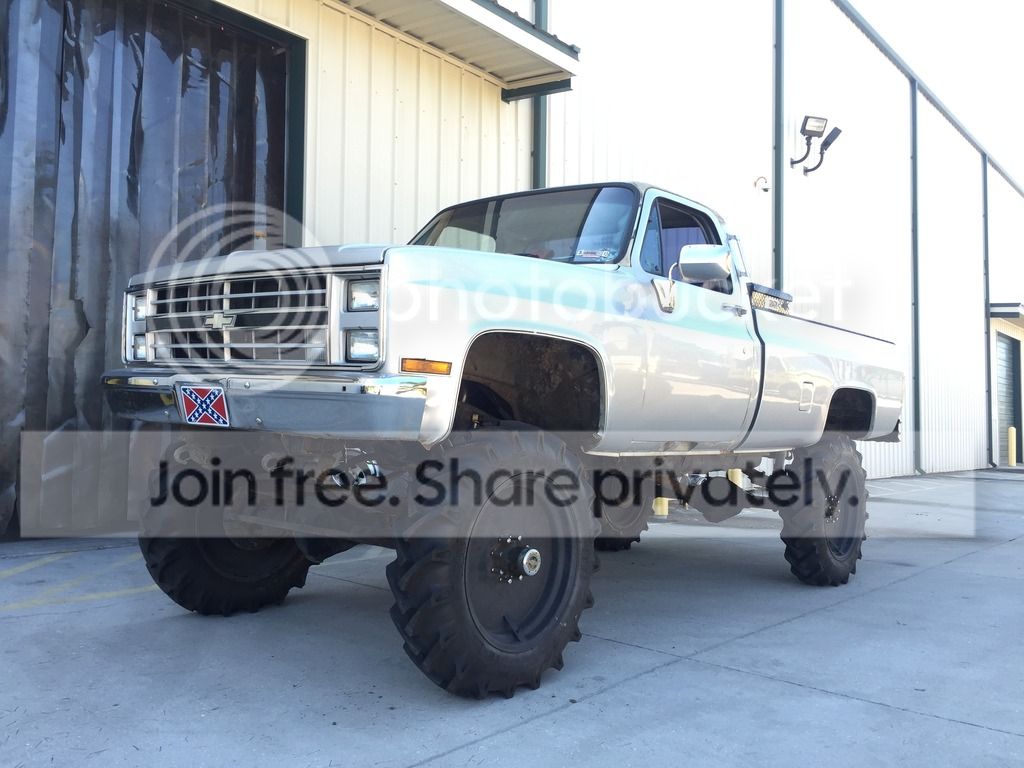

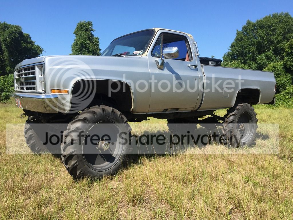

well, lets see if my one tons can hold up to these tractor tires....
01maroonz71
Jan 8, 2007
1,556
4
Palmetto, fl
I have CUCV axles, open front, crossover steering, fresh 350 th400 np208, etc. the truck did great with the 40 LTB's. just upgraded to a skinny 42in tall tractor tire. RYC is at the end of the month and we will see if 2.5 tons are in my future. hahaha. im really happy with how they turned out.
You might be ok. Being open in the front is going to help it live longer. The 14B should hold up, maybe twist a shaft. Those wheels look heavy though. Tractor tires break stuff. Guy I bought my boggers from had a set of 38" tractor tires that he kept on breaking D60 parts with....he was in the process of going to rockwells.
