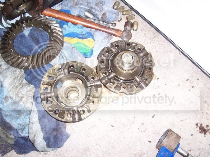

I've had a 14BFF under the Burb about 2 years now and finally slapped in a Detroit Locker last night. It doesn't get much easier then that. :bow:
With my heavy long-wheel based Burb, the Detroit is almost invisible while cruising. Getting on the gas around corners is fun though. :haha:

how easy was it really to install. could someone braindead like me put one in? did it requite special tools? did it take some sort of precise measurement, or did it simply bolt in?
it's very easy to do! I put an mini spool in my 14ff it's basicly the smae steps. here's a nice write up http://www.pirate4x4.com/forum/showthread.php?t=328610 took me about 30 minutes or so to do the install.
Ok did I miss somthing or am I a little bit confused. Don't you have to recheck your gear pattern and shims and stuff. Or am I just a tard right now. Is it really just unbolt put in then bolt back together and your good to go???
It really is that easy. As long as you mark everything upon removal, it is pretty much a bolt in affair. Here is a pretty good article about the details. :D

it's pretty easy.http://www.pirate4x4.com/forum/showthread.php?t=328610 this write is much better than the other one it goes more into detail.
