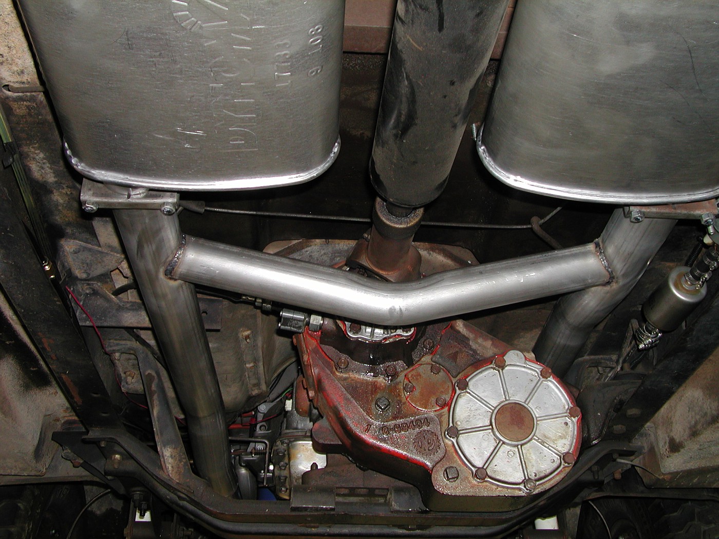

Tell me! Do you think an H pipe will do anything positive to my exhaust. I mean you see the pics above the H pipe is only gonna fit after the Xfer...is that too far back to 'do any good'?? I don't want it if it ain't doin anything.
Some clame they build torque, I like torque :D Butt again...inorder to get torque gains does the H pipe have to be in that unkon sweet spot??

After talking and talking with the owner of KB Mufflers I went with a H pipe:
I also swaped him my 70series Flowmasters for a set of BBC 50series. They were able to get the 50s to fit much higher cuz the used offset ones. I am very happy with the way KB set me up. I didn't get anymore pics, well I did but somehow my email junked them on the way into work :confused:
It sound perrty damn cool now. Nice low rumbble and RAAATTT when you get on it a lil bit. Not nearly as lound as thoes damn 40s, that is a loud ass muff hahaha

KB Muffler is at McHenry and Palendale, so nice and close to my house. Thease guys were cool. I needed a ride home fer like 20min and he said here just take my car..WOW thanks, I'll be right back! I was gonna call a cab. Got back and watched this guy weld with his eyes closed, litterally. and he twisted and bent and tossed aorund pipe like a muff diver. He obvously has been doing exhaust for a loooong time. anyway 250 bucks to run 2 1/2" pipe, install two muffs, O2sensor, Hpipe, pipe all the way out the back, custom hangers..Oh and he installed lil hooks to keep my E-brake cables away from the muffs. Cool Shop for sure!
Burt
Ya I have a 37gallon gas tank so I had him dip out and along the outside of the frame rail nice and high to the rear bumper. I shouldn't beable to damage the pipe very easly, well maby a /\ shaped rock but other than that I'm good too go.
I can grab any section of pipe(even the tip) and rock my WHOLE rig from side to side. Talk about a SOLID exhaust :D :cool1: it don't move at all :grin:
