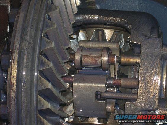

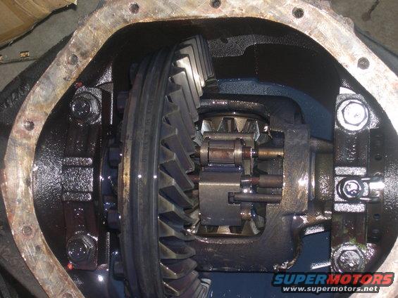

**QUESTION*** please look at the last pics. I popped open my new 14BSF 3/4 ton axle to paint the diff cover and noticed this contraption in the spider gears. Is this the dreaded gov-bomb

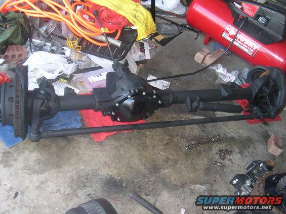

Front axle done
What is this???????

Wow, that front axle looks much better painted!
As for that rear axle, I never would have thought it looked like that in there. I know this sounds stupid (remember how I drained the fluid from it, upside down upon removal from vehicle through the vent tube). I always thought it was open...as I never wheeled that axle, and jacking it up and spinning the tire did not seem to show a locker.

Gov-bombs are open until 1 tire is 100rpm faster than the other. Then it locks up.

Yup counted them yesterday the are 4:10's I miss counted the first time and got 3:73's so I counted them 5 more times and they are 4"10's.
If you look in the pic of the rear you can see a lot of RTV frags I must have picked out 15 of them. Also what gear fluid did you use in the rear? Thanks again for the wheeling I do gov-bomb may hold up I really like the axles.

I am glad that they are at least 4.10's! I am sorry that I did not know it was a gov-lock. For any minor off-road I would have done (hunting), it would have been fine anyways for my needs. I am glad you like them!
I remember checking the fluid level when I first got the K20 they are out of. I don't remember needing to add fluid though. Actaully, the only fluid I added was to the T-case, which made a ton of noise. So, I have no idea what kind of fluid was in them. From your pictures, I would guess it was good ol' 80-90 or something and not synthetic. Just a guess.
Since I never pulled the rear cover off (just the front to count the teeth), I did not reseal it with RTV. If you picked red RTV front he front axle, well, I did that. That is good old Chrysler axle RTV, about the best stuff I know of. The front axle would have had Valvoline gear oil put back in, probably 80-90W.

The eaton Postive traction differental, commonly known as gov lock is an optional traction aid available from GM. Most 4x4 chevys came and still do come with them. This is also an option in 2wd trucks. In our trucks the RPO code is G80. This diff is frowned upon by many, however others have had no issue. It is common opnion that 10 bolt and 12 bolt axles with gov lock are junk and will hold up under stock tires and not much else. The same style of traction device in the 14 FF and SF is supposed to be stronger.
All this being said, run it until it breaks. If you dont do much hard core wheeling and have a light foot it will live. Take care of it.

I have a gov-lock in my 14 sf and the general consensus around here is that if its in anything other than 10/12 bolt then its okay, it just doesnt have the manners of a detroit or the like. Everyone I talked to about the 14sf is youll be okay up to a 38 inch tire or so, then you might think twice about the gov lock
Like already stated, run it till it breaks. For us people on budgets that just wanna have fun, go with what you got.
Ohh I wasn't complaining about it I just know that it isn't what some people go out of their way to have and I got the axle from Jolene who didn't know it was in there and I was actually just suprised when I popped the cover and saw it and I had never seen the gov-lock so I wasn't sure that is what it was. Something about you can't put a detroit in it????
Anyway this is a project build so they way I look at is for now I have a free traction device which I assume is better than an open diff and if it breaks I will deal with it then. I will be running a 37" tire when it is all done but 36's for now. My wheeling will be getting to wherever the duck are!!!!
