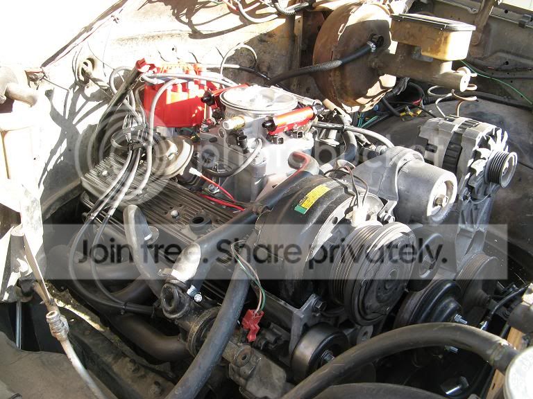

I want to replace this alternator with something that puts out more juice. It's a one wire plug, plus the obvious power wire. I pulled it from a junkyard truck when I got the serpentine belt setup. I think it was a '94 1500 w/4.3. I'm just looking for 200amps and probably a one wire hook up. I see CS130 and CS144 and some other listings, but haven't a clue. What does everyone recommend?
Think that's a CS130.

cs-130 is stock on serp belt of our vintage. 105 is max factory amps. and if much more than that needed from cs130 dont bother. way to small and heat buildup problems.
i did a cs-144 upgrade from ebay seller and its 200 amps and 125 at idel. was over 5 years ago if i recall.

I never really understood the numbers but I remember coming across them a while ago. I took the smaller alternator off my 2001 S10 and put a 2004 Avalanche alternator in it's place. It was much bigger. Plug and play, all I needed was a 1" longer belt.
It looks just like a CS130. Definately CS series. They come in different "clocking" for different applications, so pay attention when you look for a donor. Something to look into is running a sense wire for that thing. It could be that the Alt isn't maxed out and you just have voltage drop in the wiring. You can run a sense wire to your battery or somewhere and have it compensate for loss in the main Alt wiring. Or just start by looking at the main wire to see if it is long or skinny and address the problem there. Which is more important; performance or having 1 less wire? What are you running that needs so much power?
