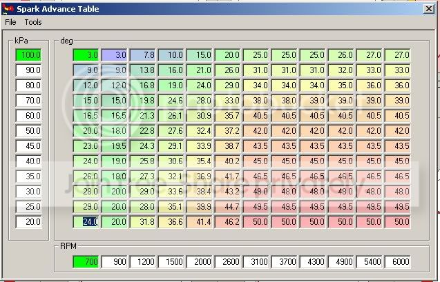

Wait, timing is just one number? Oh, you must mean initial timing. Mine looks like this:
