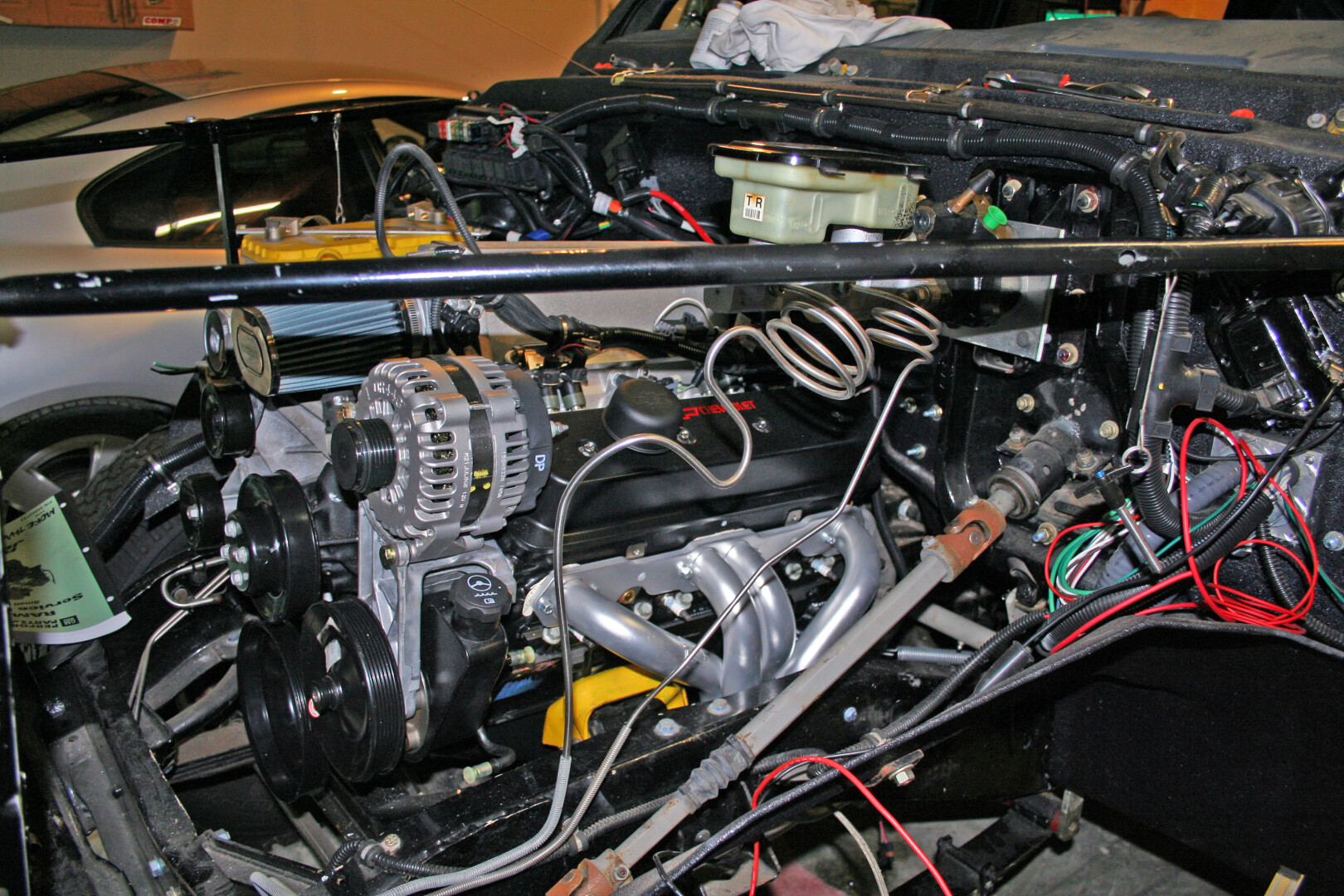

and "73K5blazer" dear god of all that is sexy in an engine bay!!!!:eek1::thumb:
