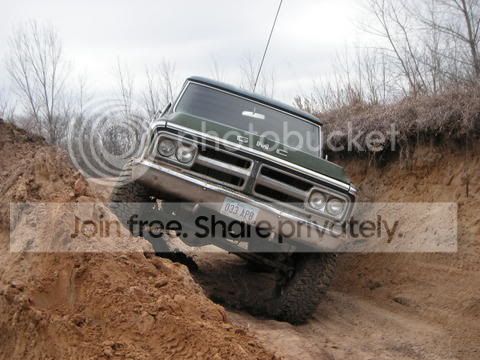

42's on 15x8's with 2.75" backspacing. The tires stick out just enough to keep the body away from embankments, etc. The width of my Ford is basically identical to a Blazer with 38x12.5's on "regular backspacing" 16x10's. Not sure if this will help you much:
21750
