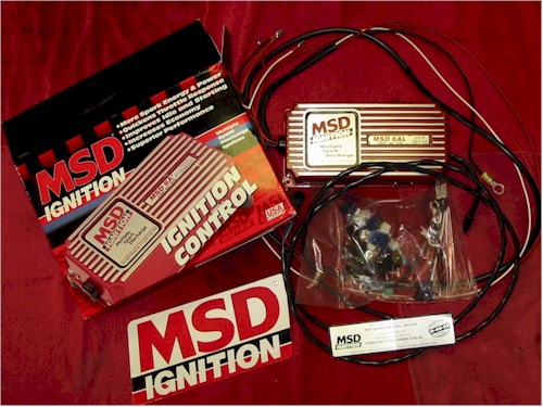

my ignition module
my ignition module
hey i have that same one.haha.i have never had a problem with my hei besides the little spring contact under the coil going out.i run a accell coil also.im petty sure heat is the biggest issue to why a module goes out.when you connect to outermost pos and neg terminals on the cap.should get reading of 6000-30000 ohms for primary.if not replace coil. the ohms should be close to zero resistance with good continuity frompositive to center pin on cap.then you leave the one lead on the center terminal of the distributor cap and check for continuity also to the tack terminal.use high scale and if both readings are infinite the coil is faulty.that is for in cap coil.outof cap module should be primary 1 to 2 ohms and 3000 -20000 ohms secondary.of course all of these tests should be done with negative on battery disconnected.
