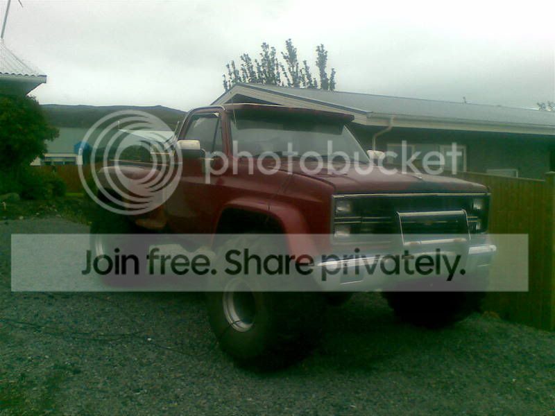

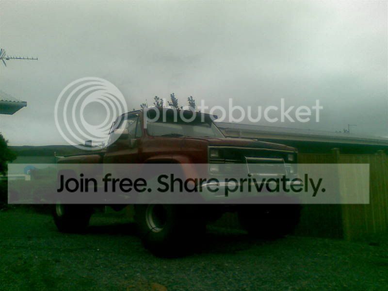

This is my truck.
http://i72.photobucket.com/albums/i180/Hjalti_GTO/08092008001.jpg
