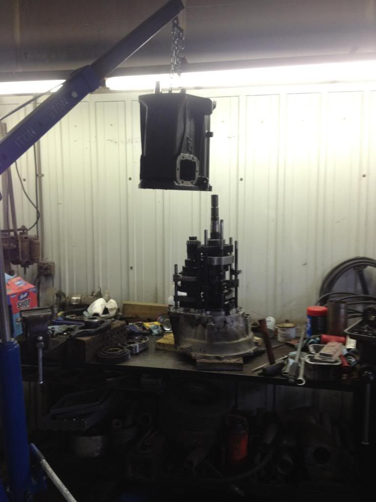

What did I just take out of a 2003 Dodge 3500?
It was low on lube, but I am not sure why. Seems like the lube was coming from the top? It had two PTO coolers on it.

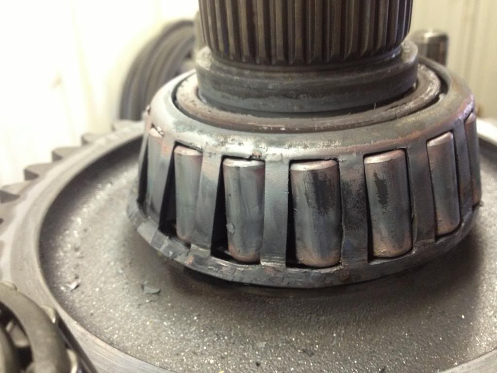

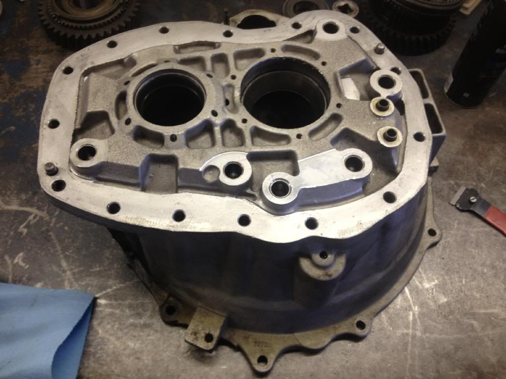

If it's not over filled the output bearing doesn't get enough lube. That's right from stock. Poor geometry. I had one just like that except the race spun in the case. Case is junk. If the case is junk you have nothing but a pile of parts.

I'll know more when the new race shows up, but it fell out of the case....
No one is making an oversized race to repair the case?

I believe Loctite make a product for spun races.
Or I could take it to the blacksmith shop in Spalding and have them fix it.
Martin
Locktite green is sleeve retainer. I can double check the number for you in half an hour. It well may work to hold the race in. But your on borrowed time the second you put it to work that way. Is it worth it? Just depends on how often you like pulling 250lb transmissions and spending a metric ****ton of money on them.
