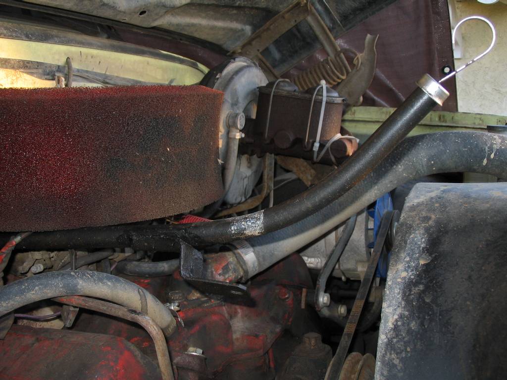

I thought the Van dipsticks were a cool idea for "lifted" trucks.
Put's the end of the dipstick where you can easily reach it.
Pic from another members truck.I think he runs 35's or 38's on his 1st gen.

That pic is of the trans dipstick, not the engine dipstick.
i'm with you on this being a tranny dipstick. i just think that it looks funny. it is easy to check so it may stay. idk just askin what others would do

what kind of motor is that? the freakin alternator's on the driver side. hmmm looks like a homemade alt. bracket too
Whats the story on the ZIP ties around the MC? I don't get this tube thing cuz if that tube runs down to the tranny it seems it must have been lengthened. The L bracket hangin off the side of it is supposed to be bolted to the bell housing.

I don't know why but i was thinking you were talking about the engine dipstick. The van engine dipsticks are also very long like that so they will reach the radiator support.
wow how'd i miss that. it was an engine dipstick i was talkin bout. never even thought tranny dipstick cause i have the manual. oops thanks for all your guys help though
