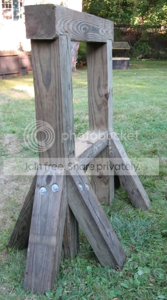

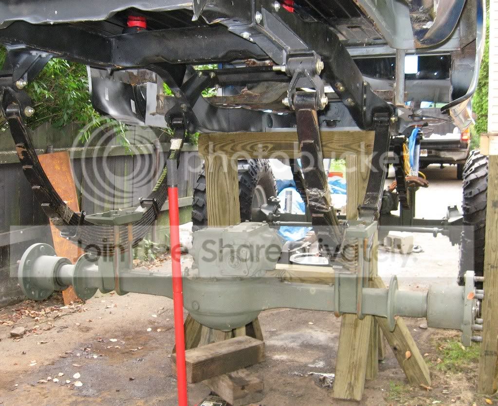

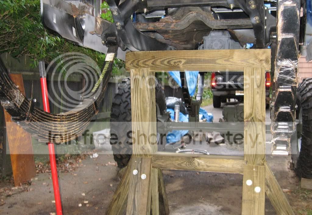

I made this out of 6X6. Mine is over 50" tall, but I'm sure you could make a couple at any height.
Here it is under holding up my truck as we speak.
