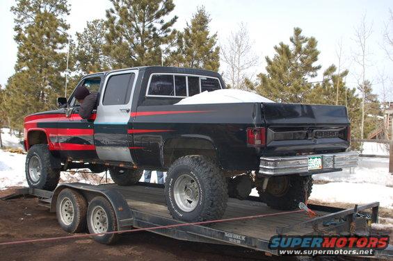

So I bought a Crew Cab that has been shortend to use a shortbed.

I can take it apart and fishplate it. I have lots of work to do on the truck anyway. Here is a quick picture.
That looks cool. I like the crew with the short bed. If you got work to do on it anyway, I would plate it.
