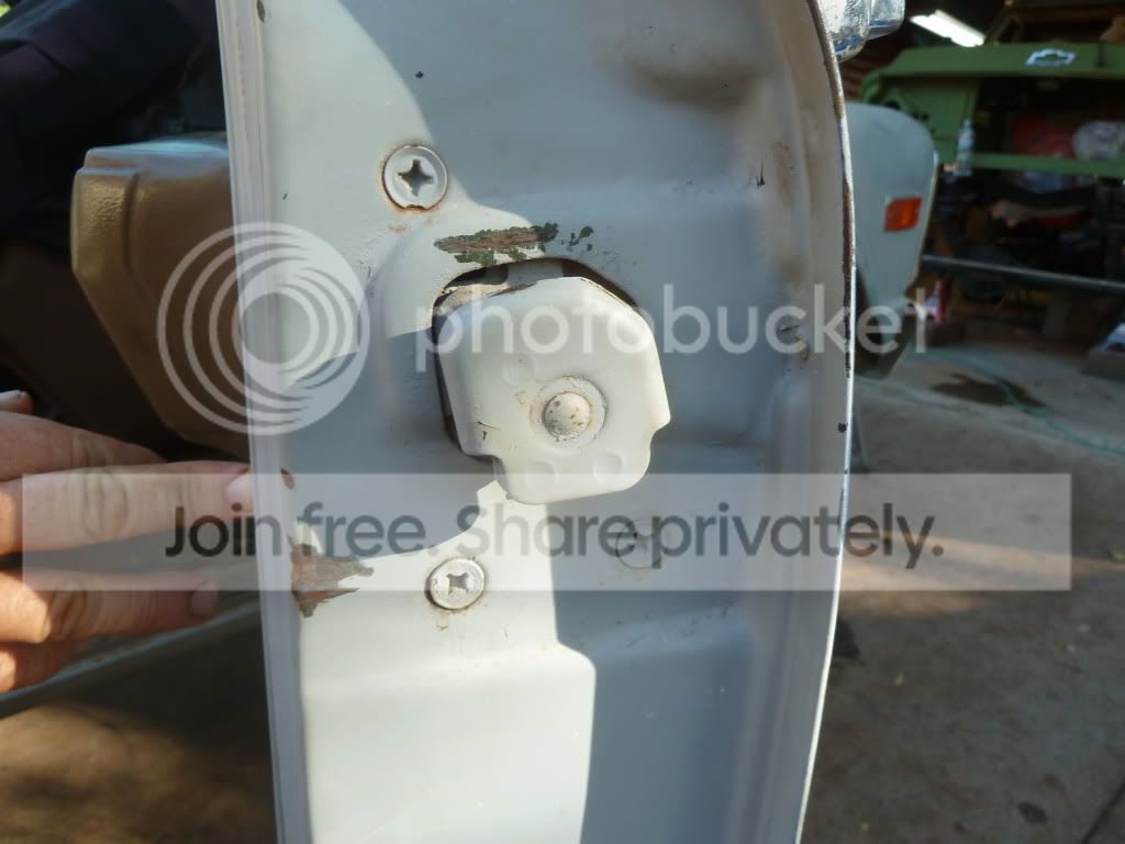

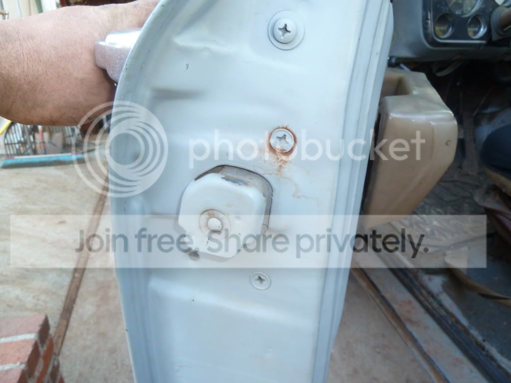

Did every year have the reinforcement plate on the doors? I have looked at my friends and mine, both 69's, and they didn't have them. Though, they could easily be not the original doors on both.
Friends drivers door.
Friends pass door
Mine in the bone yard look the same.

They may not have had the plates in 69. I bet it was one of those things that they discovered after the first year or so.
I know the screw is on 71-72, but not sure about earlier than that.
-Brian
Mike, are you sure they are original blazer doors? I know many times people will make a set of truck doors into blazer doors and not move the plates. That being said it wouldn't surprise me if the didn't have them in 69 or even 70...
