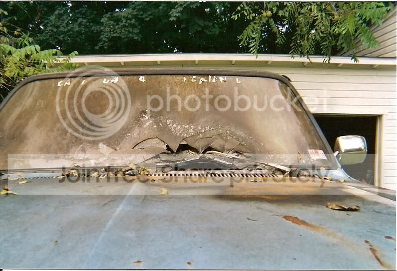

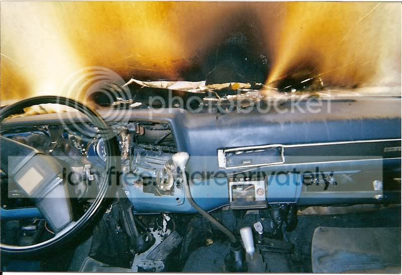

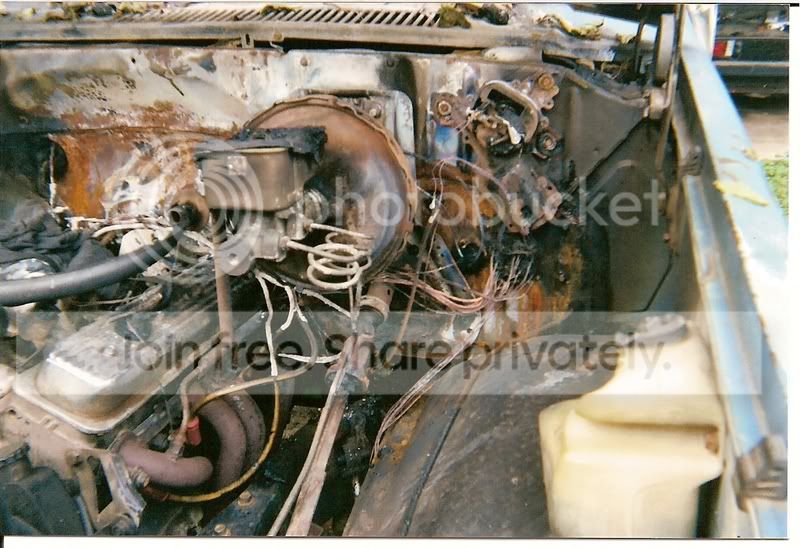

I have put out a fire on my own truck and one on a friends truck. the mess that a dry chem leaves is nothing compared to what the fire will do if not put out. my brother caught my truck on fire while I was at work. unfortunately the extinguisher mounted to my seat had just been used to put out my friends truck that weekend prior.
