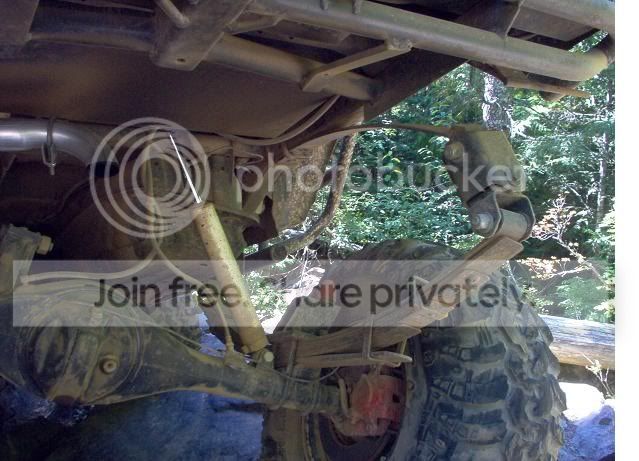

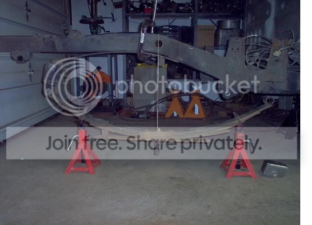

yea I like the idea behind 3/4 elliptic. Its pretty simple to set up and If I were to put it on my truck I already had an idea of a way to pin the 1/2 spring in place in case I didn't want a lot of travel.
Some people will say that this setup will cause the rear suspension to unload excessively when going downhill, which is true, but nothing a center mounted limit-strap, or rear mount winch could prevent. I plan on installing a rear mount winch to suck the rear down for downhill decents

why didn't you leave the c-clamp holding the spring on?? :confused:
looked like it was a doing a good job :D
