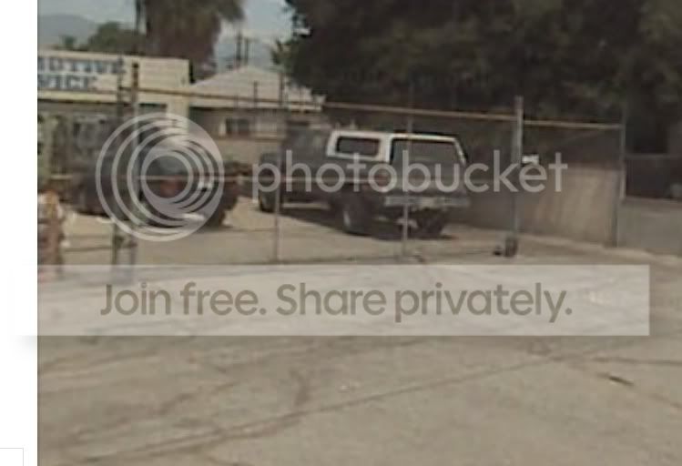

I see a nice 4x4 crew cab in the back of a auto shop every day on my way home from work. Mike's Automotive Service, San Gabriel, CA. Find the phone number and give him a call.
*I've never talked to him, nor do I know anything about the truck, but I sure do like looking at it driving past. Picture is straight off google maps.

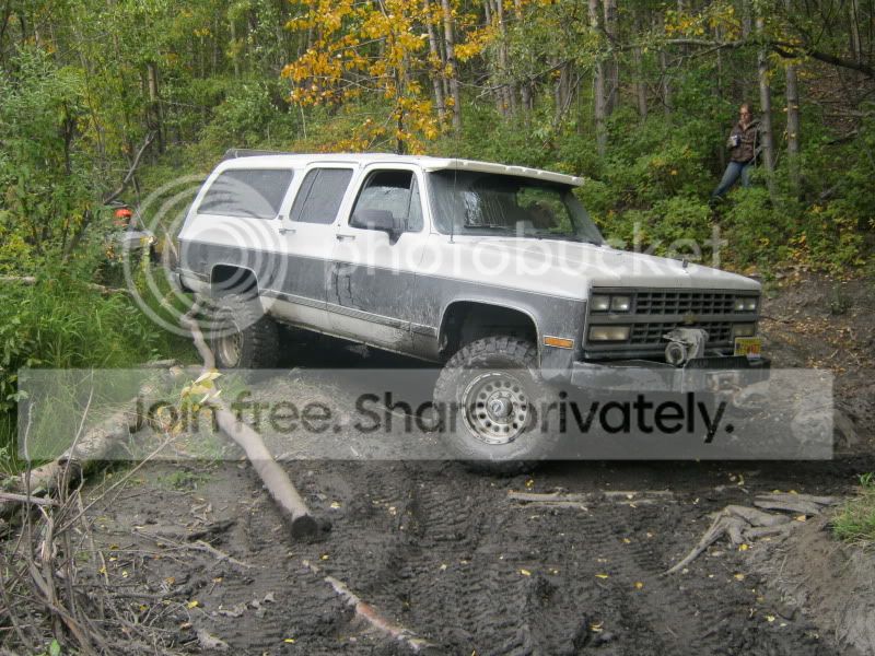

The White Burb gets 20-22 Mpg on 1-tons and 35's
The Red Crew Cab gets 19 Mpg on 33's
The Gray crew cab gets 18-19 on 35's WITH A TURBO and TH400
The Blue Burb gets 20 with a Turbo and A TH400
