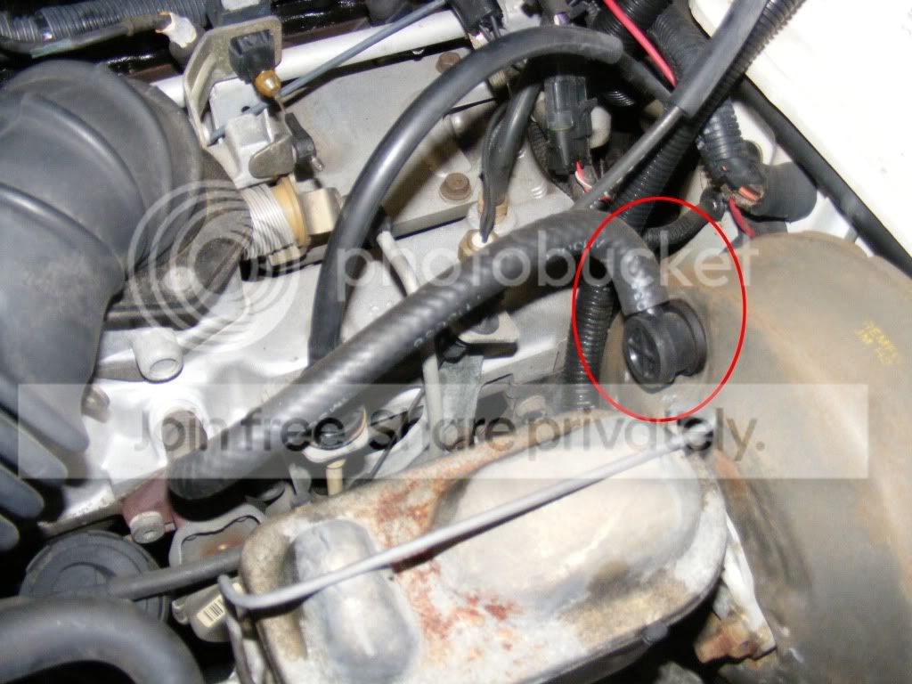

On a related note, does the proportioning valve require vacuum? I just swapped out my factory carb for an edelbrock and there was a large vac line running from the factory carb to what appeared to be the prop valve. Not sure which port on the new carb to tee it into...
*edit* I've been lurking on here for so long I didn't even realize this is my first post! So I guess a Hello Everybody is in order.
That large line supplys vacuum to the brake booster.
Prop valve is mechanical.
I got the brake booster line no problem. I'll have to go out and take some pics of the one I'm referring too.
Sorry to hijack the thread.
