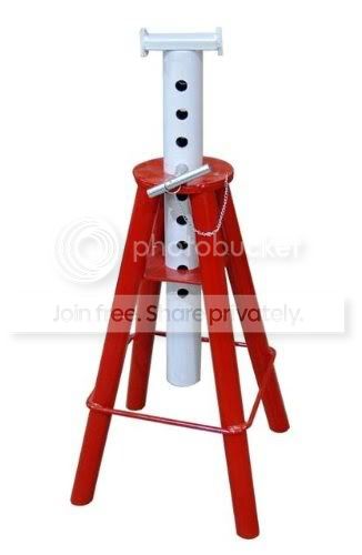

Just went down to hf to buy jack stands. 12 ton with max lift of 30 inches? Will be changing axles soon .i have 38s on the truck. Will these stands suffice?thanks!
nope. but will work if you crib up from the ground to the stand to work. use good thick blocks of wood. or find some taller stands for like a med-heavy size truck.
be vary carefull as doing all this work on stands will be a bit wobbley at times.
dont forget the hight of frame now to ground is with full weight. when you lift it up the springs will drop down good 3-5" more sometimes with the weight of the axle on it.
I can take him back I guess. should I take them back? if these aren't the right ones can somebody lead me in the right direction? how big should be?

I just didn't wanna get stuck with jack stands are too small . Lol. as all be changing axles out more than once in this truck. are there any bigger ones I should buy???
these work well but you need to get high enough to get them under, I made a custom pad for my jack to give me an extra 8"
As mentioned, it can. I have two pair of stands that size and some assorted smaller ones, and have changed axles, springs, you name it.
I don't like having the truck that far up without the suspension anyway, so I do the phased approach. Jack up the axle and take the tire off, then put the frame onto the stand.

Wow thats sweet! yeah napa sells some that are 30 to like 46 inches! 325 dollars
I set my stands under the hitch receiver assy. The receiver is plenty strong to hold the weight of the truck and it buys you an extra 4-8 inches depending on how low it drops from the frame.
I'm swapping out axles now and this is the set up I use.
Two 6 ton jacks up front at the front of the springs. Two 4 ton jacks at the frame underneath the doors. Each jack sits on a pair of 6x6's mated to a 13"x12"x 1/2" piece of plywood.
I used the transmission jack on one end and a floor jack on the other and was able to slide the dana 60 in place fairly easily.

Wow actually the hf jack 30 inch stands are Perfect! Ample room for the stands to expand even with the stands under frame .even with 38s on the truck,the tires are least 2 Inches off the ground. I have everything loosened up and the truck is just chillin on the stands for now. Question tho. I ended up putting the stands on the springs behind the axle,,,,until I can get time to get at it again .but,is this safe? Feels sturdy idk. I dont want to die haha http://coloradok5.com/photos/showphoto.php/photo/24516/cat/500
either put em under the axle, or the frame...
and like i mentioned, ALWAYS give the vehicle a good shake before getting under it...
Everyone seems to put the stands in FRONT,on the frame but,is it ok to put the stands on the frame BEFORE the springs ,engine,etc?or will it have a posible teeter totter effect?i was hoping on just rolling the whole assembly in from the front. I dont have a bbc lol
you can generally put the stands right behind the leaf springs... right in that front cab mount area... mine is supported there right now, with a motor in it, and no trans, t-case...
