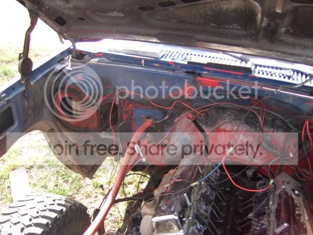

http://coloradok5.com/forums/attachm...1&d=1215036561
heres a pic of what im talking about
hmmmm. i'm a bit confused by that picture. did you cut a new hole into your firewall, and simply cover the other one?
now i gotta get off my ass and go look at my firewall.

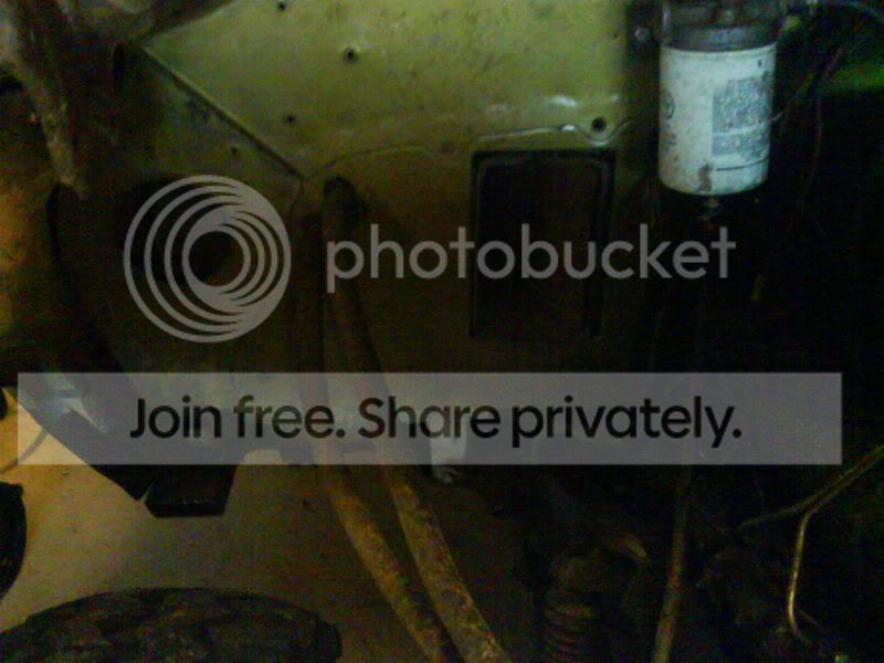

take a gander at post #8. you can see my current firewall (the green one, crappy phone pic), from left to right, has a hole in it for the fan, then the heater core nipples, then the hole where air is directed through so as to get into the cab of the truck. this is your typical a/c firewall.

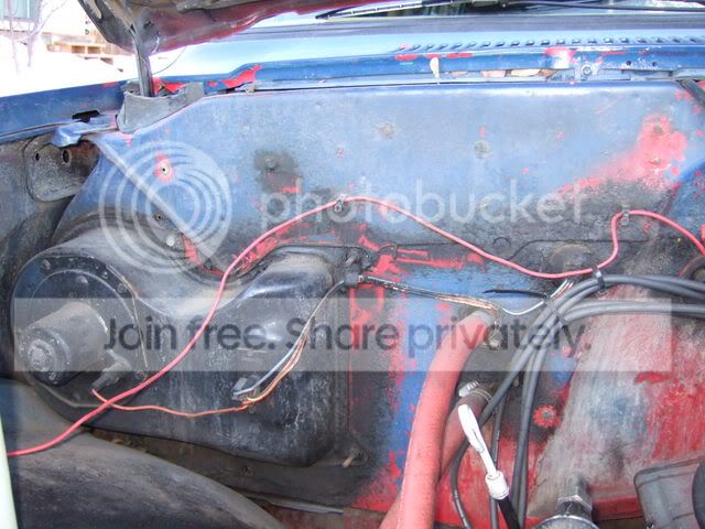

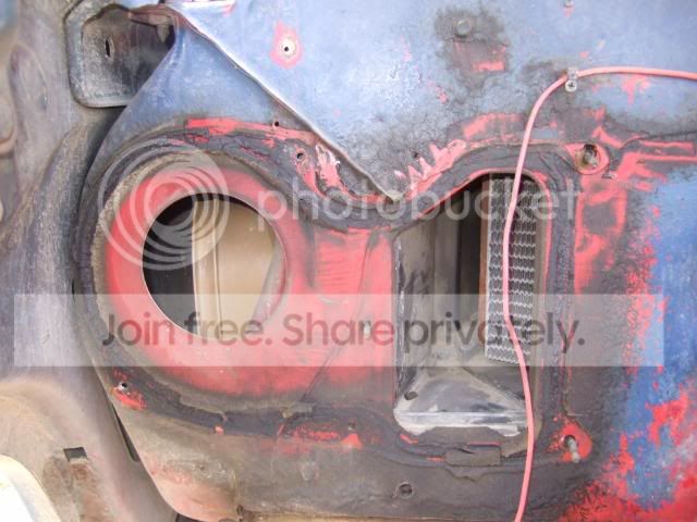

look at pic #5 in post number 10, you'll see that his firewall holes, left to right, are for the fan, then the entry into the cab, then the nipples for the heater core. so, it's not as simple as taking a fan box off of a non-a/c truck and sticking it onto mine.
