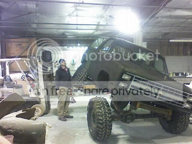

39.5" Iroks, stock 64's and stock 52's.

hoodrich, sweet look truck man, can you get some more pics, like the amount of trimming you did and such? plannin on doing a similar setup on my next truck. thanks
