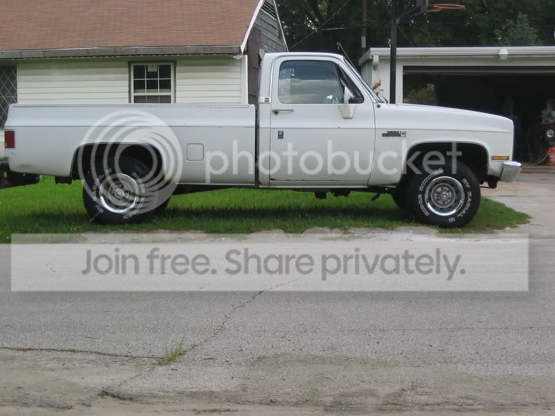

I just wanted to put this overdrive in my truck since I already had it,
the motor to. Maybe i will just stick to the 350 trans :) .
I'm thinking my next mod's will be a 4 inch lift with 33x12 1/2
and 15x10 inch rims :D
Why would you want to go with a 350 trans? You would have to modify things to get the 350 to work since it is designed for a TH700R4. If I have gathered correctly you have NO transmission right? I would get a TH700R4 to put back in where one was before and go ahead and use a 454 if you'd like.
Your lift and tires sounds good to me.
LOL, I have a 350 trans in it now, I put the 91 camaro 305 in the truck
and 3 month later blew it up :D that was just with regular freeway flying.
I kept the trans from the camaro to, cause it had pretty low miles, I knew one
day I would want to put it in the truck with the 454, and get better freeway
gas milage. But I do have a 350 trans in it now, and with the overdrive I knew
I would get better off the line pep. :grin:
I may just go ahead and put the 700R-4 in and see how long it last. I know there will be no offroading going on.
