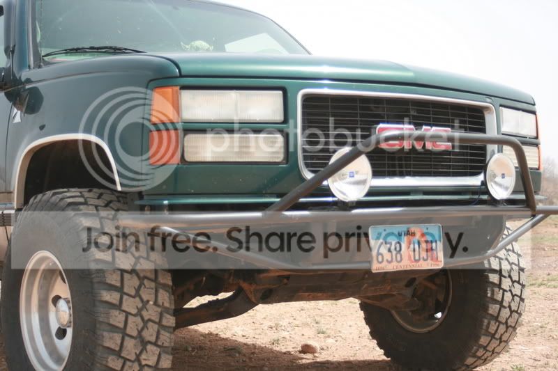

This is exactly the direction I wanted to go with my 97. BUT other than lifting the front 4.5" and building the front bumper I didnt get very far (yet?) And it is 4wd!
