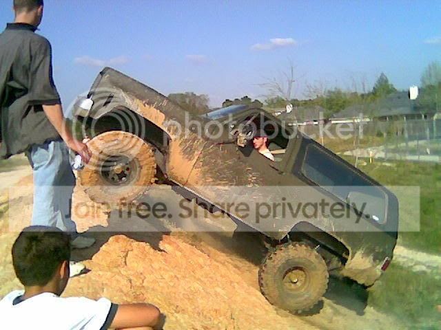

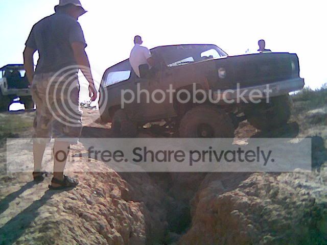

Took the '77 out for the first time this weekend. It did really well until I blew out the rear end.
Check out that frame flex! Found out there's a couple body mount bolts missing.

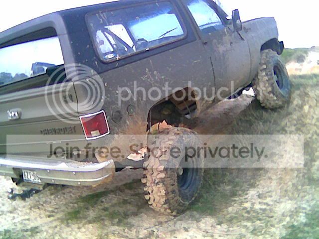

Found out I need lockers.....
And found the first part to break here......
It shattered the upper and lower spiders. So we welded the side gears to the carrier to get me home. The weld must have let go on the pass. side cause I now only have right wheel peel, but the pass. side axle doesn't budge, so I assume that just the weld let go. It ran good and pretty smooth on the highway after this on the way home. So I'm assuming that the R&P might be ok.
