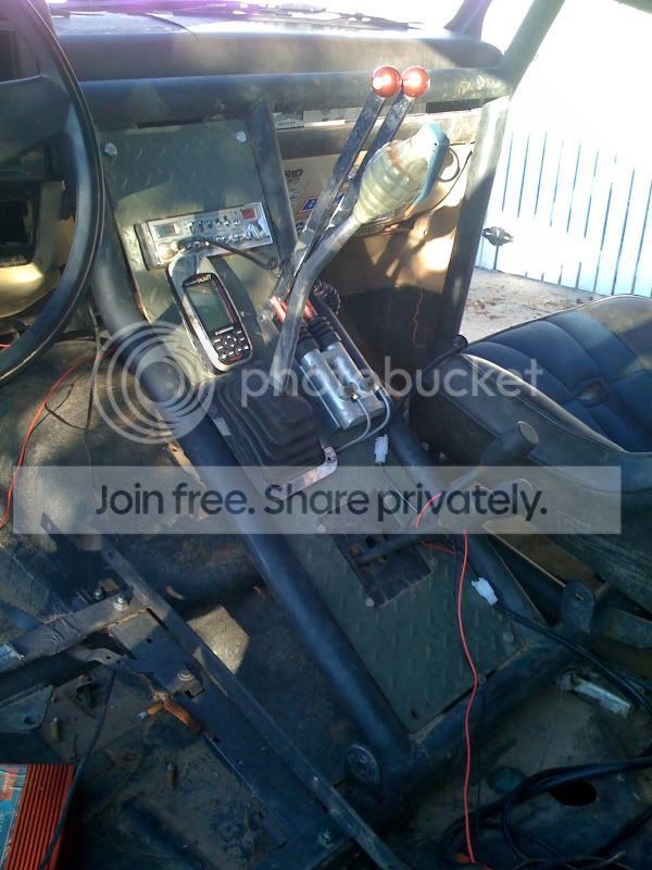

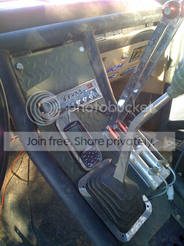

Yeah, ryoken has a nice set up with his AC shifter and some very trick custom work to go with it. I'd do what Paul has done but I already spent the coin on a Tuffy plus not many of us don't have the skills to pull off what Paul did with his shifter.

The Lokar stuff is pretty cool.. I STRONGLY looked at it before I went with the AC...
just wasn't exactly sure of what shifting/gates/stop setup the Lokar shifters had, and if it would be good for me...
I'm glad I went AC tho... freakin thing is bulletproof.. I removed my first gate down on the right side to make it more street-friendly, works killer..
as for mounting. the shifters ARE very narrow, so that can help... whether a Tuffy could be shifted back or over or something, to work, I'd have to look at it..lots of guys have bracketed, or cage mounted ones off the trans hump..
as for the Tuffy's... anything is possible, it's just how much work... ideally, I would guess without looking at one, the perfect location would be all the way in the front, left corner of the TUFFY...
I'm sure that would be some moderately extensive modding to an expensive console.. cutting out sections, new support walls, ribs, edges, etc...but I'm sure doable.. could be pretty sick looking... one that was a little dinged up and could used a repaint or something? sure why not..
or if it would fit, bolt it right to the side of the Tuffy, the mounting bolts come in from the side of the AC...
you can see the bolts on one side of mine, the other side of the shifter has the same config... actually my old one will be up for sale very, very soon...
yup, no clue on thread size, never took mine off.. i'm sure it's some standard knob size prolly...
